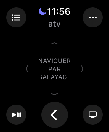

my 6th gen is running OS 11.6, and give me an extra appletv remote complication..

And because I have a full Apple config I can also control my music and my Apple TV… (1 Apple TV connected to my samsung, 4 homePods + Apple Music for sound and home theatre)
