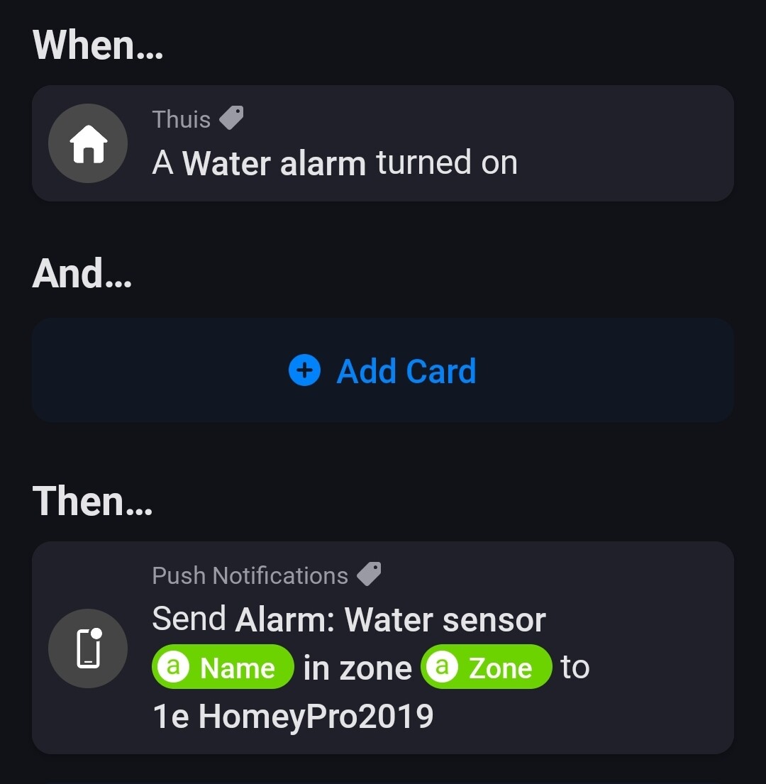

You can use this triggercard “when [alarm type] turned on”
You can select “water alarm”
When you use the local tags [name] and [zone] in the notification card, it will show which device alarmed.
Local tags, provided by the triggercard, are always on top of the selection list:
