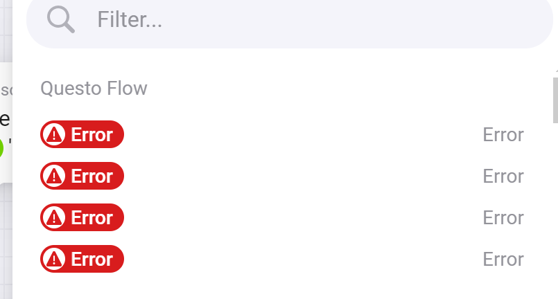

Hi, when I have several error tags how can I understand which card they refer to?
Hoover with the mouse over an Error tag.
The tag icon on the corresponding card becomes blue.
Thanks!

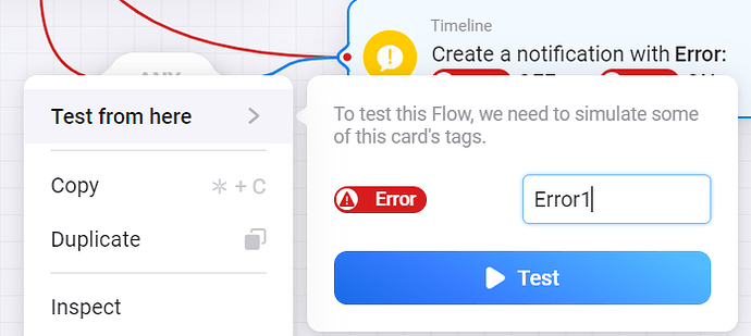

See the simulation with the result here:
The ANY is placed to have a virtual starting point.
Testing from that point like an error “Error1” occured turning the TV-Off
This results in an Error in creating the Timeline Notification (or any other part of a Flow that uses the Tags from the Error.). That just fails, nothing appears on your timeline.
