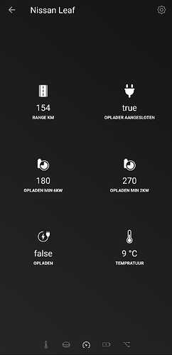

At the moment I am working on making 1 device for my Nissan Leaf. Had this to date in different virtual devices and it works.
I downloaded and installed the Device Capabilities app here.
I have created several fields within a device that I want to fill from MQTT.
However, I cannot choose the values ​​of the MQTT in the Text field. I think thevariable is not seens as text but as number.
