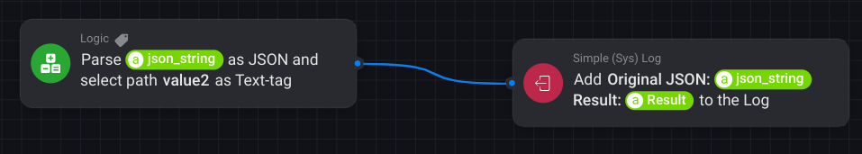

You can use this Logics flowcard
I saved a string in a variable, and it only returns the value of value2 (which could be temp or humidity in your case)
In use with message trigger of MQTT Client, you can do something like this:

i don t have the flow card parse when i create a new advanced flow ![]()
It’s an action (Then) card, I guess you looked at the And cards category?
How to spot: It has only one output ‘nipple’, so it can’t be an ‘And’ card.
