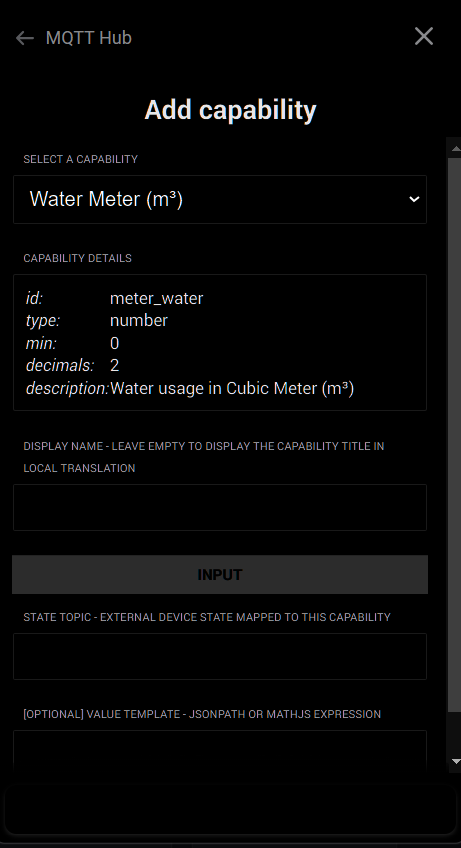

Is it possible to change the number of decimal on a MQTT water meter virtual device? I would like to change from 2 decimal to 4 decimals. When I create the Virtual device and select water meter I see that its stated with 2 decimal, but I am unable to select anything else.

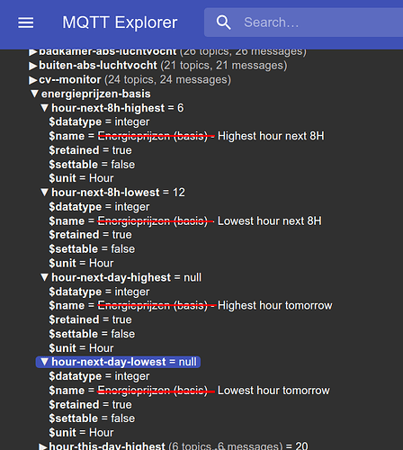

Today I updated my Home Assistant to the new version 2024.2.0. Now it shows me all MQTT names twice. In another forum I was told that this has something to do with the URL link below and that the Homey MQTT app needs to be updated. The topic was already announced in August 2023. Until then, the developers of the respective integrations had to make the adjustments.
This is the link:
PSA: MQTT Name changes in 2023.8 - Configuration - Home Assistant Community (home-assistant.io)
This is what it looks like for me:
Print-Screen
I’m now back to 2024.1.6, everything looks normal:
Screenshot 2024-02-09 144625
Anyone else having this problem? How can I solve the problem?
Gruss
feron
I see the same issue as well.
From what I’ve read in the topic you shared, I understand the MQTT Hub app should get some adjustments, like:
only devices should hold the device name, the entities of these devices should not.
Visual:
Unfortunately Harrie is quiet since August 7 '23…
