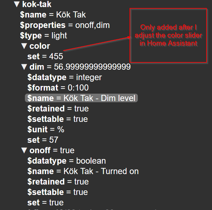

Yes, the light you show in the screenshot only has a dim and onoff capability. That color topic looks to have been created manually or via an incorrect HA color control attempt and is not $settable or being used by MQTT Hub. There is maybe another topic elsewhere that HA is using via MQTT…(if it’s working)
I see you say HA created that set topic, and that HA control of that light via MQTT works ? Or are you saying tuneable white / colour doesn’t work from HA but onoff and brightness do… which would make more sense ? If so I am surprised HA is getting a colour control topic from MQTT Hub for this bulb… it shouldn’t be sending one.

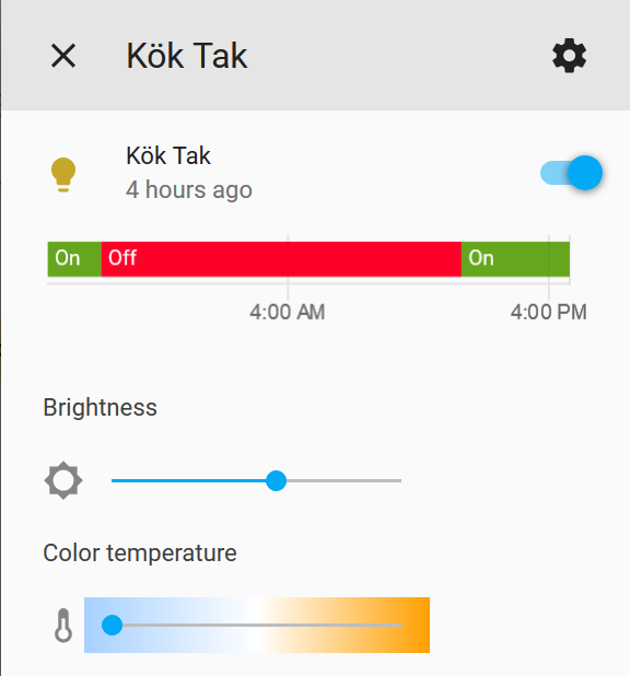

The lamp is added in Homey as tunable bulb. MQTT Hub then creates it in HA via auto-discovery. It shows the tunable slider in HA.
But the capabilities/properties broadcasted by MQTT Hub as shown in my previous pictures are only onoff and dim.
The lamp can be fully controlled from Homey interface (onoff, dim, colortemp). But MQTT Hub only sends onoff and dim commands. If I adjust the color temperature, nothing is sent to MQTT.
From HA I can control onoff and dim, its sent via MQTT, picked up by MQTT Hub and Homey sets the lamps accordingly.
The problem is that when I adjust the color temperature from HA, HA sends the commands via MQTT, hence creating that topic as shown in my MQTT-Explorer picture. But it is not acted upon by MQTT Hub and Homey is not adjusting the color temperature.
So the strange thing is: MQTT Hub sets up the tunable bulb correctly in HA. But does not react upon the color_temperature adjustment.
