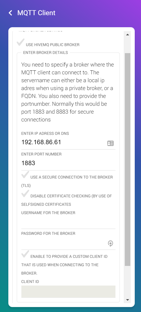

Only settings in client are ip-adress and port.
Or is it just my limited mqtt and mqtt explorer skills? :slight_smile:
@dhanjel
There is a log in the MQTT client app too which may be more use here…
You do have the beta version of MQTT client installed (not the release version) ?
You can try enabling the “Enable to provide a custom client ID” checkbox in MQTT Client settings. MQTT brokers don’t like empty or duplicate name clients.
The username / password are set up correctly … (if you use them on your broker)
I tried that also (you never know) but although I entered a client id it keeps on sending the messages under the previous ID (‘homey’). I restarted the apps on Homey, Homey itself and the broker.
@Julian Topic root (default:homie) & device id (default: homey) can be configured from the MQTT Hub app general settings tab. Do you have problems changing those?
The Client ID setting from the MQTT Client probably has no effect on app2app messages (at least it shouldn’t, need to check this).
Furthermore I’m going to test a build in mqtt client. I hope it isn’t needed, but maybe it solves some of the above issues and can result in increased performance (less socket connections).
@HarriedeGroot I am still on v1, so I do not have a settings page.
Then fortunately you can’t change to root topic…
I did not have the beta version, that did the trick! Thanks
I think I may have found my problem! I had installed the MQTT Broker for Owntracks and used the userid/pw on my NAS for that also for the Homey MQTT Client. I assumed Homey just needed access to a broker. I started from scratch but made a seperate user id for Homey on my NAS and now it seems to work! Just tested and I was able to make a switch in OpenHAB that controls a light in Homey.
