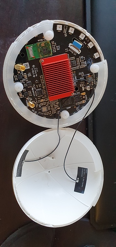

So, two days later i have already some early conclusions:
Dome:
As you may have read above i got some troubles with the top dome, not achieving to get between the top dome and the plastic center ring
I tried to pop the screws from the bottom dome but that doesnt seemed to be a realistic option for me, those screws look solid!.
I ended up to break the middle ring but at least that lifted the top dome and allowed to pop it open
Zwave:
I got the following antenna
I wonder if this antenna is the right one??
I removed the existing antenna and only fixed the center wire.
I did heal all the nodes after a couple of hours, buts its a desperate mess
I did not see any improvement for the far away devices,
And it worsened the mesh and reachability of the close-by devices

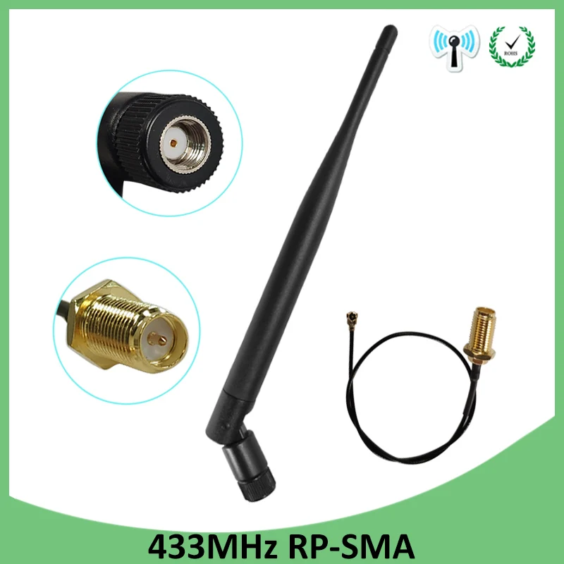

433:
I removed the homey 433 antenna, and connected the center wire from below in the hole the old antenna left
So far i see a real improvement, i don’t have devices far away but even the close ones were an issue beforehand.
now i can reach all devices and have no more errors, i can use my 433 devices like with my previous home boxes!
Especially with blinds and temperature meters its a real improvement!

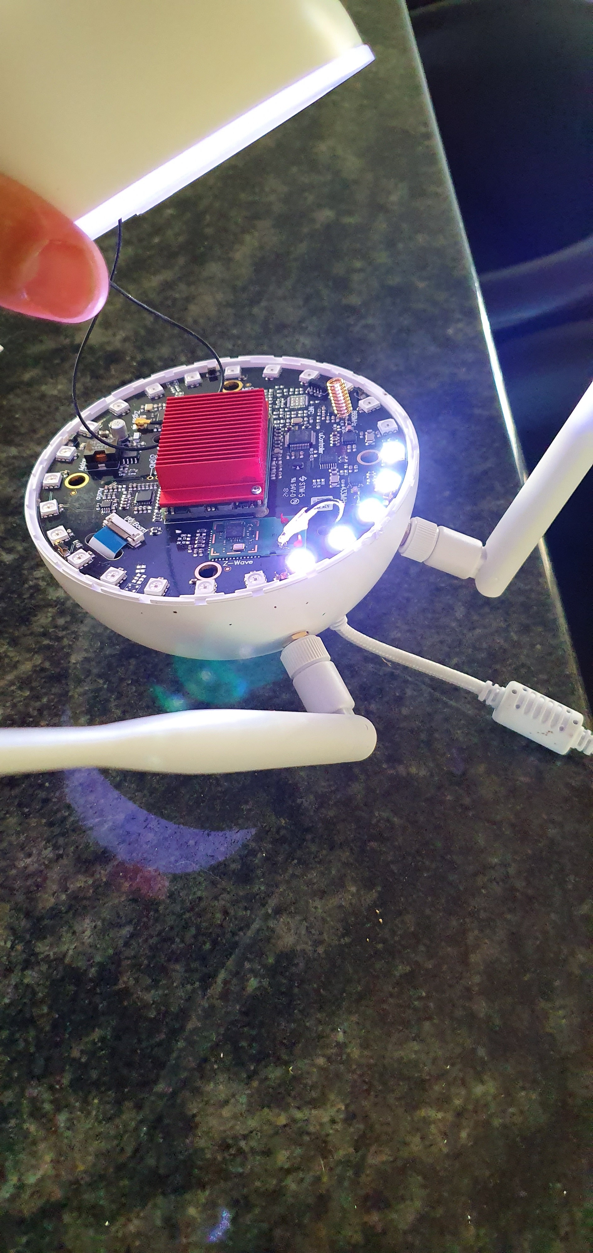

So remounting the homey and putting the plug back, i noticed that only 1/5th of the LEDs do light up
The leds work correctly and can change pattern, only five of the leds light up!
I checked for damage, i checked for dirt, nothing, not a single damage!
i found not a single trace that could explain this issue.
I think the LED’s are addressable (WS2812’s or something), which probably means there’s a trace broken between one of the last lighted ones in the chain.
There should be three traces between each LED. If you have a multimeter, you might be able to find a broken trace in continuity mode (make sure Homey isn’t powered up when you do).
i’ll get a Multimeter, the traces are really really thin though
You should be able to use the pins of the LED’s, they are connected to each other in a chain. Look up a schematic on Google (I don’t know if Homey uses 6-pin of 4-pin LED’s) to see which pins are connected between the LED’s.
Oh, thats a butcher work you done to Homey :joy:. I would not be surprised if led next to the opening crater is not damaged.

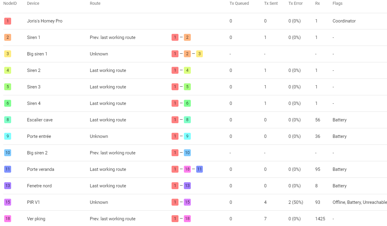

Well if you look up to my mesh, nodes are connecting to unreachable nodes or battery powered nodes, and some very close by devices are now unreachable.
Do you think my antenna is a wrong modell?
It should be not related to antenna. Wrong antenna would cause more intensive routing or unreachable devices, but it shouldn’t cause routing over the battery powered devices. BTW where do you see routing over the battery device?
That’s not even possible with Zigbee, so Homey is lying.
So node 3 goes over node 2, which is battery powered!
Sometimes its worse,
But Node 2 is not flaged as a batterie device?
Its a basic neocoolcam siren/doorbell on battery
All the sirens you see on my list are battery powered but not flagged as battery
