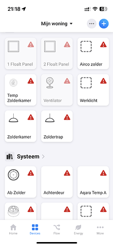

How did you do that test-migration? I have a HomeyPro Backups account so first thing I treid was tried a HomeyPro-2019-Backup onto my HomeyPro-2023.
That didn’t work wel, every device got a little red triangle and nothing worked. (This was 5 days ago)

Nope unfortunately peanutbutter,
Only some wifi devices such as sonos and Eufy robovac are responding
Rest (70 devices) need to be re-paired…
thats gonna be a job for a rainy Sunday…
