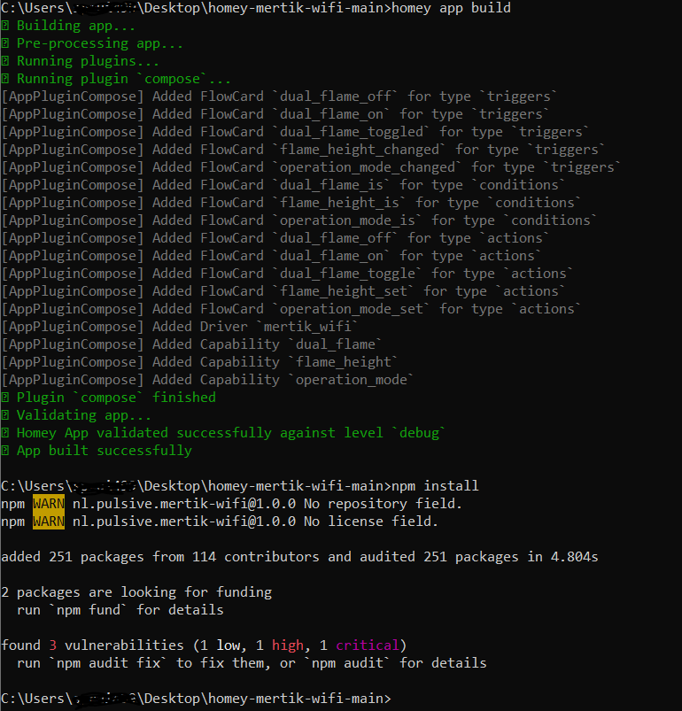

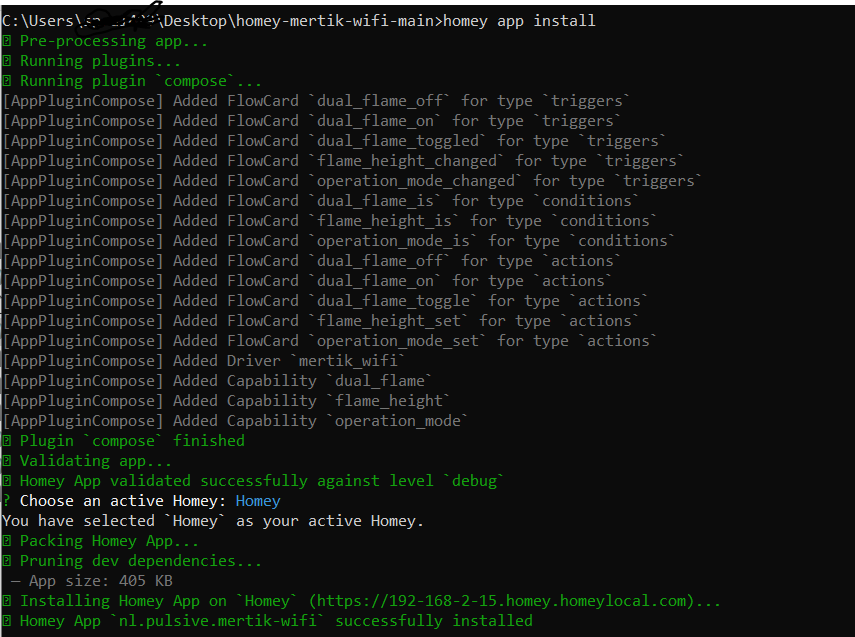

FYI: I also did:
  1. install Homey SDK: install node.js + install athom-cli + login
  2. homey app build
  3. npm install
  4. homey app install
during 2: I got these warnings:
1 and 3 installed well.
