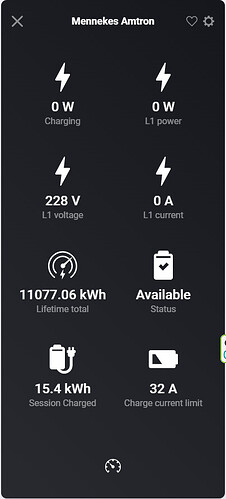

Hi @Migaelo ,
I’m working on a app for the Mennekes Amtron. It’s my first app so it takes some time, but it’s in progress.
You can not control the charge state of the charger but you can set the charger current (as low as 6A).
Currently I have MQTT and node-red (Docker on a nas) in between, but I want to eliminate that and move everything to Homey directly.
Best regards,
I have something working but need some more testing. It’s now only for a single phase but I’ll add support for 3phase later on. The control state of the Amtron chargers is controllable, it can be paused according to the documentation.
