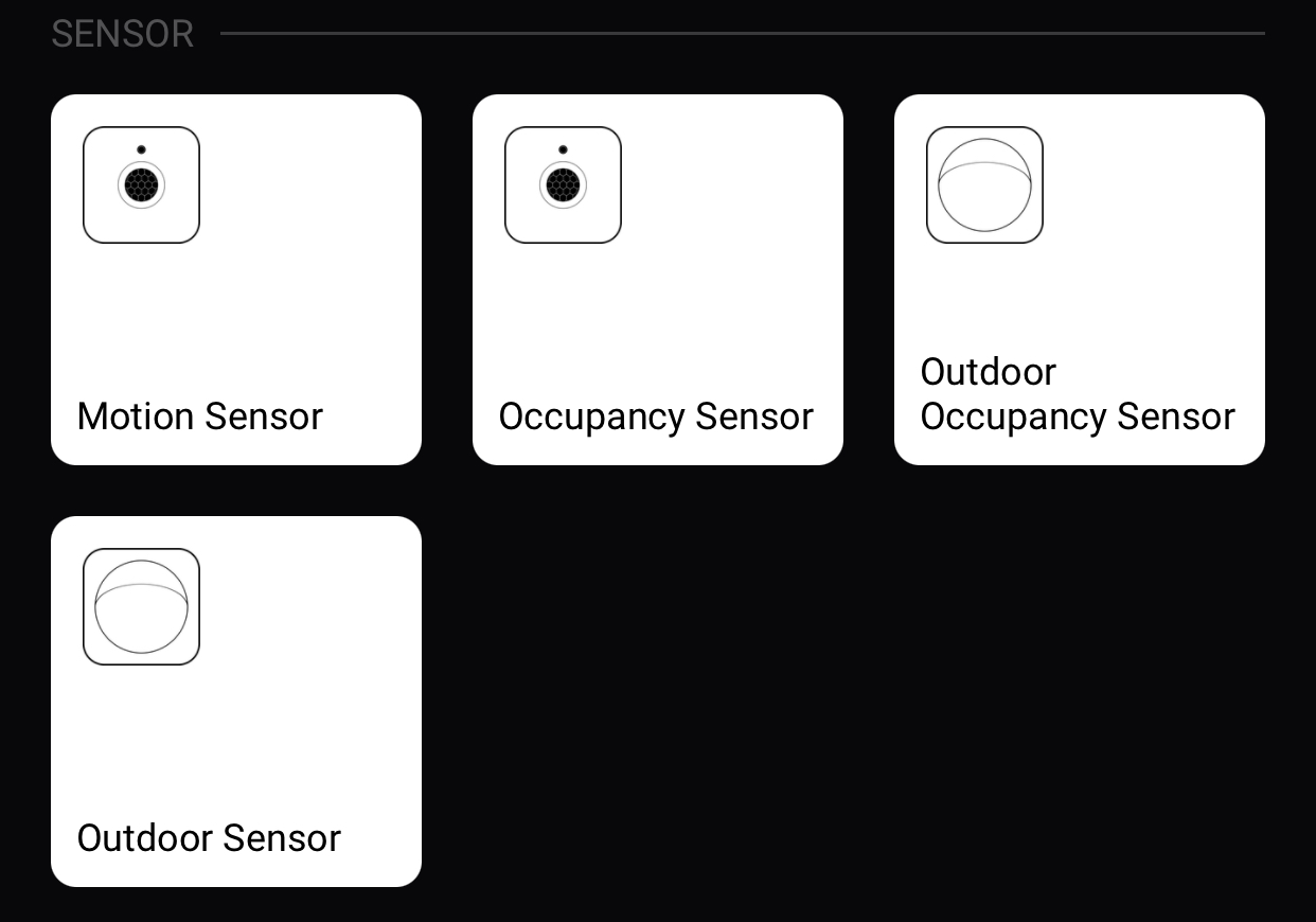

Hello Johan, Could you tell me, how to "change to the occupancy driver? Or is this another sensor
You have to delete and add the sensor again and choose “Occupancy Sensor”.
This works great. One thing, the battery status is no longer available in this setup

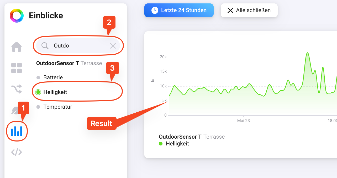

Could you please share the code on how to plot the lux level from the Phillips Hue Outdoor Motion Sensor?
It’s called ‘Insights’
You can do it also this way:
