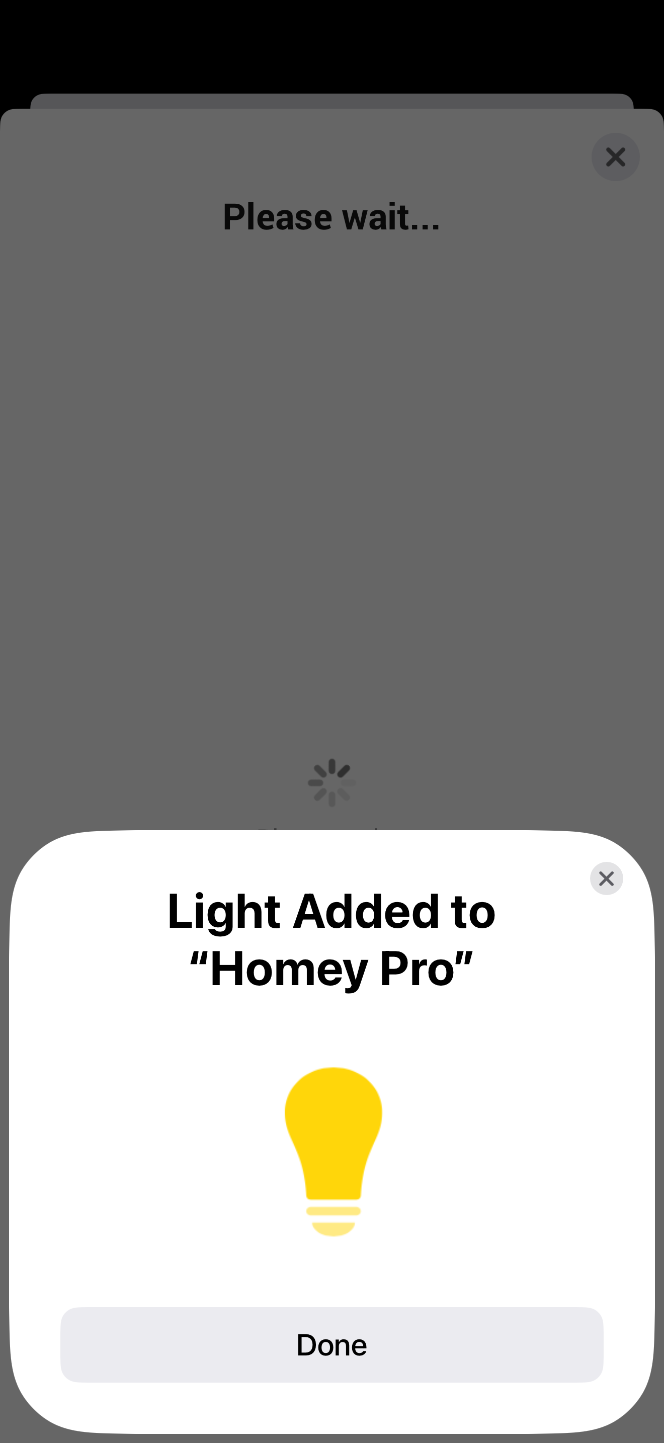

I have 4 Linkind Matter smart bulbs connected to Homekit natively and share them via matter to Homey Pro. A few weeks ago, one of the bulbs just disappeared from HP. The remaining 3 are still there and work fine.

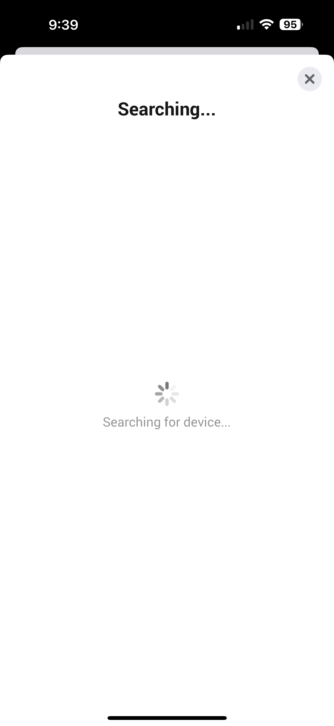

I have been trying to add that lost bulb back to HP via matter and it will just not work. I have been trying for a week. I have factory reset bulb, added to Homekit and tried to share via mater iOS and still no luck and looking for ideas. I was able to do this before…added all 4 to HP almost a year ago so don’t know what’s changed.
I’m thinking it’s a networking issue because I have having issues with Eve Motion Sensors shared via homekit to HP as well as Govee matter to Homekity ( I know not HP issue but thinking that’s it networking) but I just don’t know.
Setup:
Everything is on same wifi and vlan. And I mean everything and all firewall rules are turned off. Using Ubiquity Cloud Gateway Ultra with U7 Pro AP. Homey Pro, HomePod, homekit, all my devices are on same 2.4 Wifi connection. IPv6 enabled. I am able to start the process but it fails at the last step.

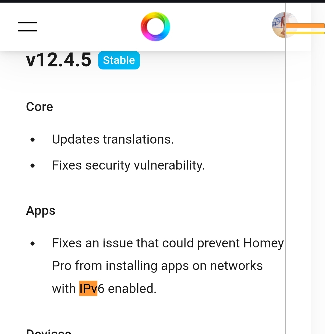

Anyone have issues with Homey Pro not receiving/assigned IPv6 Address after last few firmware updates? I just noticed this after reading matter/IPv6 articles. I have done the router, modem, homey, device power off reset.
With the v12.4.5 firmware update they “fiddled” with ipv6 settings.
Maybe they introduced a new bug along the way?
UGH. I need to start looking at those details before upgrading LOL. This is frustrating as heck. Anything already adopted or established in my Apple HomeKit and Homey Pro ecosystems work flawlessly. But I can not add or adopt any new devices or share devices across ecosystems via Matter to Homey Pro.
