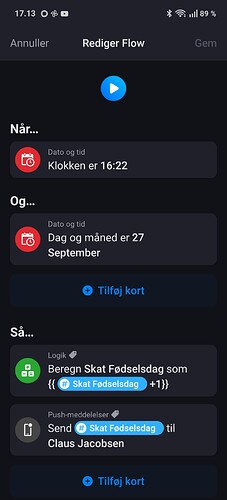

Can someone help me with this flow. It ends in NaN
My best guess is that the variable is empty. Try storing a number in it manually and then run the flow.
In addition (if not already done so) you’ll need to add a 1 sec delay to the push notification card. Otherwise the variable has not yet been updated to the new value (both THEN cards are executed in parallel). And you’ll receive the old value in your push message.
The issue was the delay
