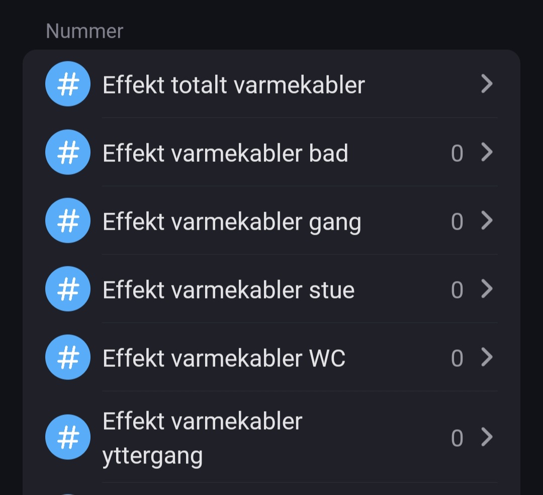

The top variable seems to be empty. Make sure the numeric variables have a value, even a zero is valid.
When one of them hasn’t got a value, the calculation can’t be made.
The first one is the output, i try to change it to a number, but everytime the flow runs it just get back to NaN.

Can you check if all variables actually do have a value when the calc is done?

Probably your variable got ‘stuck’ without a value, or something non-numeric somehow.
To possibly solve it:
My guess would be to remove that variable and then create a new one.

Thanks, made the variable again and that made the trick. Thanks for all help
