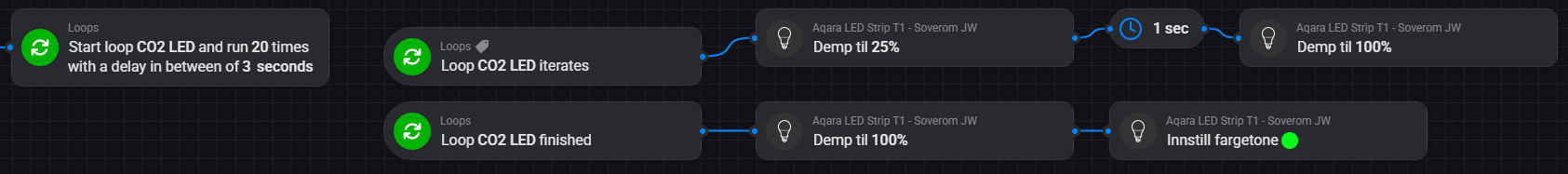

I tried the loops app which works pretty great! should i consider trying the other app y’all talking about too? i don’t know what would work best?

I think it doesn’t matter.
Only if you had Chronograph installed already, it can save Homey’s memory for running an additional app like Loops.
