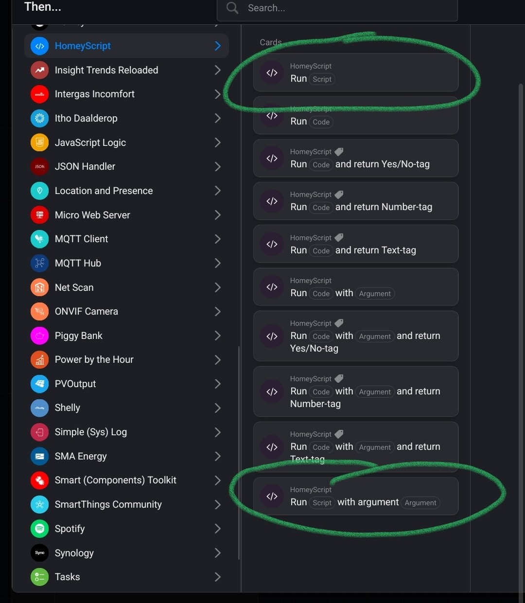

In an Adv flow you can paste the script code right into one of the available Hscript cards:
and/or
You can call any of your saved scripts from here
with one of these two cards:
