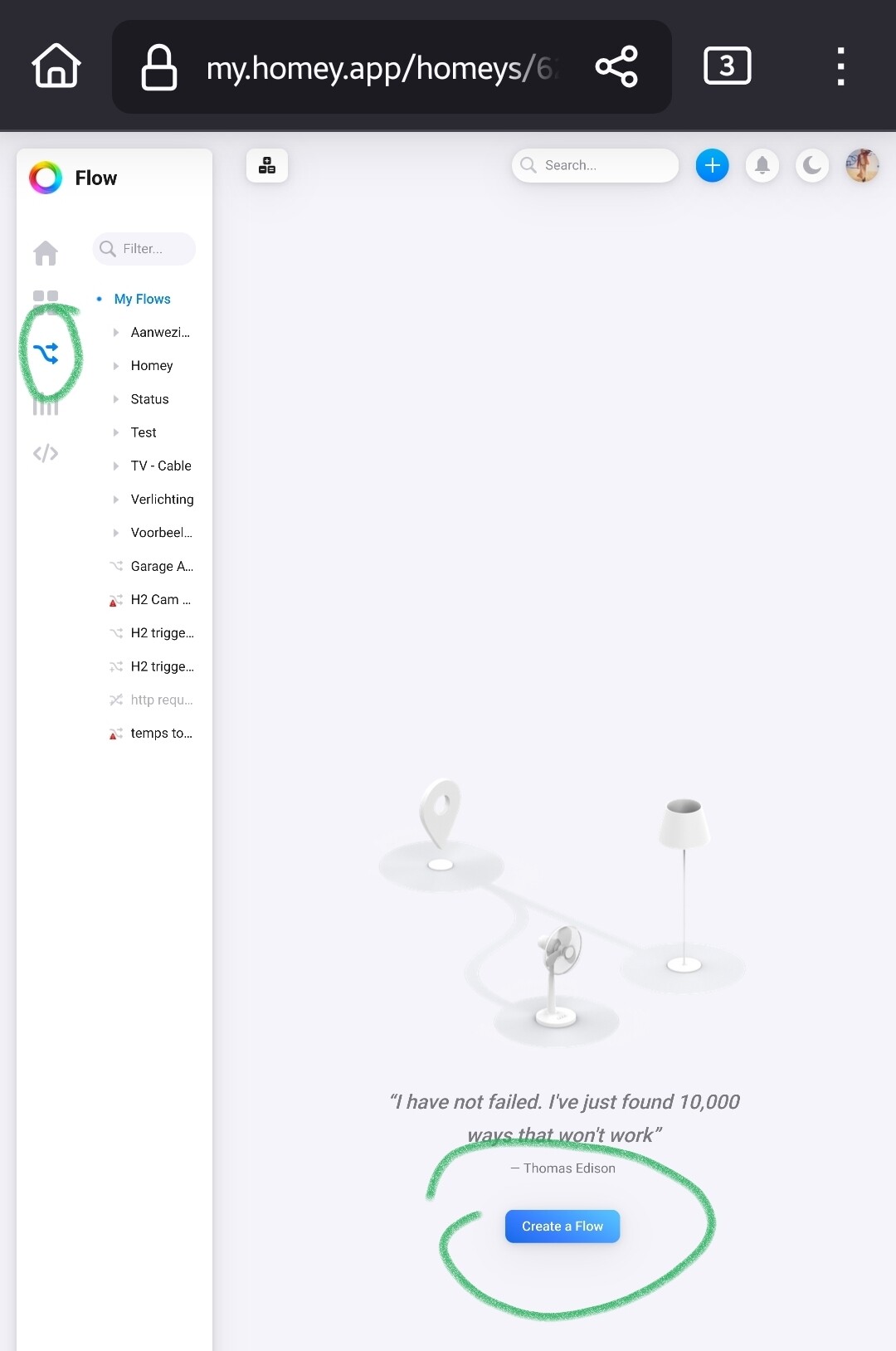

Homey’s Knowledge Base might be a good starting point. It has a separate section on Flows.
Also Homey’s YouTube channel contains information on building flows, like this one:
Only in web app available:

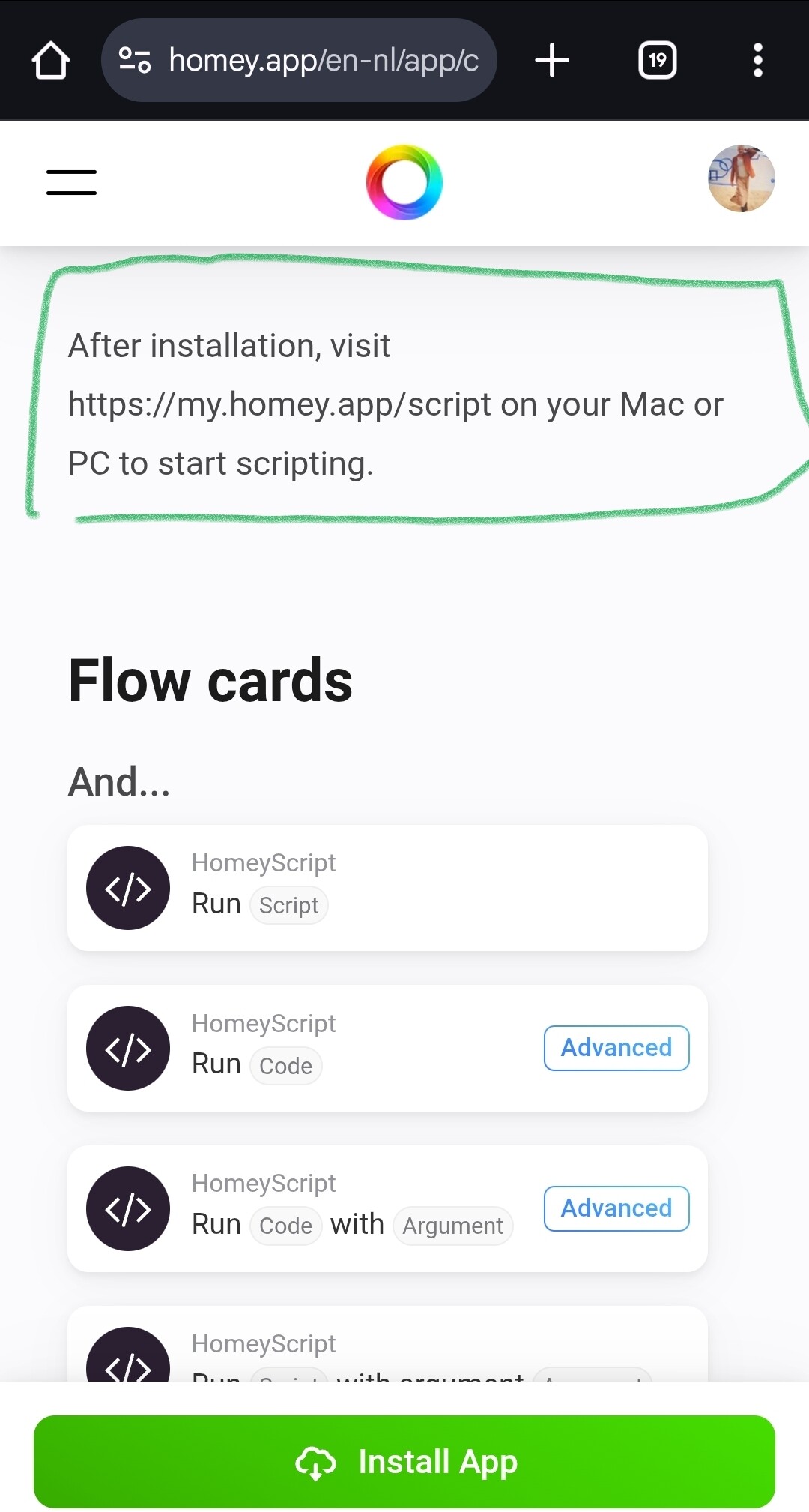

  • First install Homeyscript from homey.app store

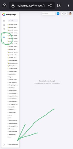

  • Next, goto my.homey.app with your fav browser (I think Chrome works best) and log in with your Homey account
  • I prefer to enable the browser’s “Desktop view”
  • Tap on </> icon
  • Create new script
  • Paste code
  • save, and tap :play_button:

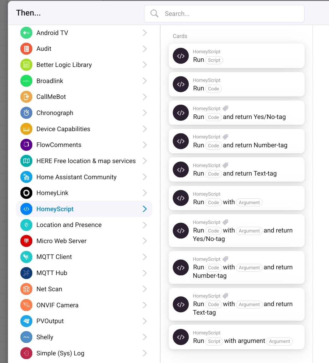

You can run code in HS advanced flow cards as well.

The short version is at the app store as I just found :rofl:
