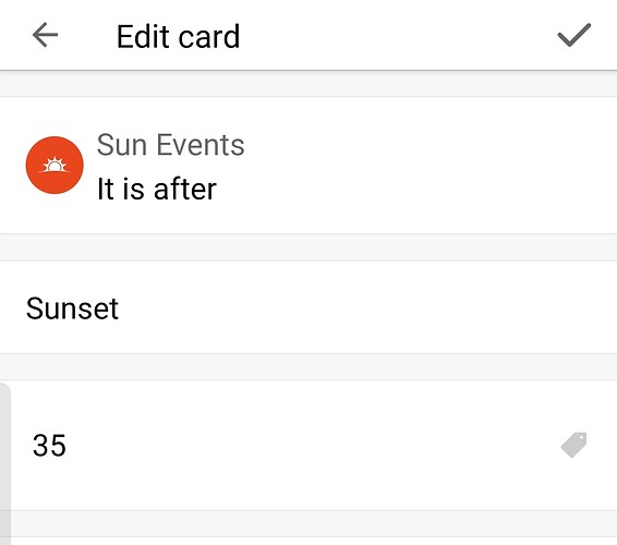

I’m missing an example of a flow where a lamp, when moving on a sensor, comes on. It should only do so 30 minutes after the sun has set and until the sun rises again. It should be properly dark before turning on. I’ve messed with sun events but can’t get it to work properly. I’m missing an example of a flow where a lamp, when moving on a sensor, comes on. It should only do so 30 minutes after the sun has set and until the sun rises again. It should be properly dark before turning on. I’ve messed with sun events but can’t get it to work properly. I don’t think I quite understand the app :drooling_face::joy:
Zoomed in on the ‘after sunset’ card, 35 is the offset, so it has to be 35mins after sunset before the condition is true
