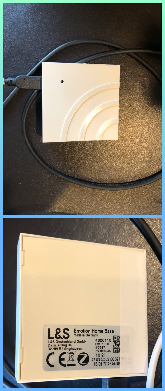

The L&S driver with Home base

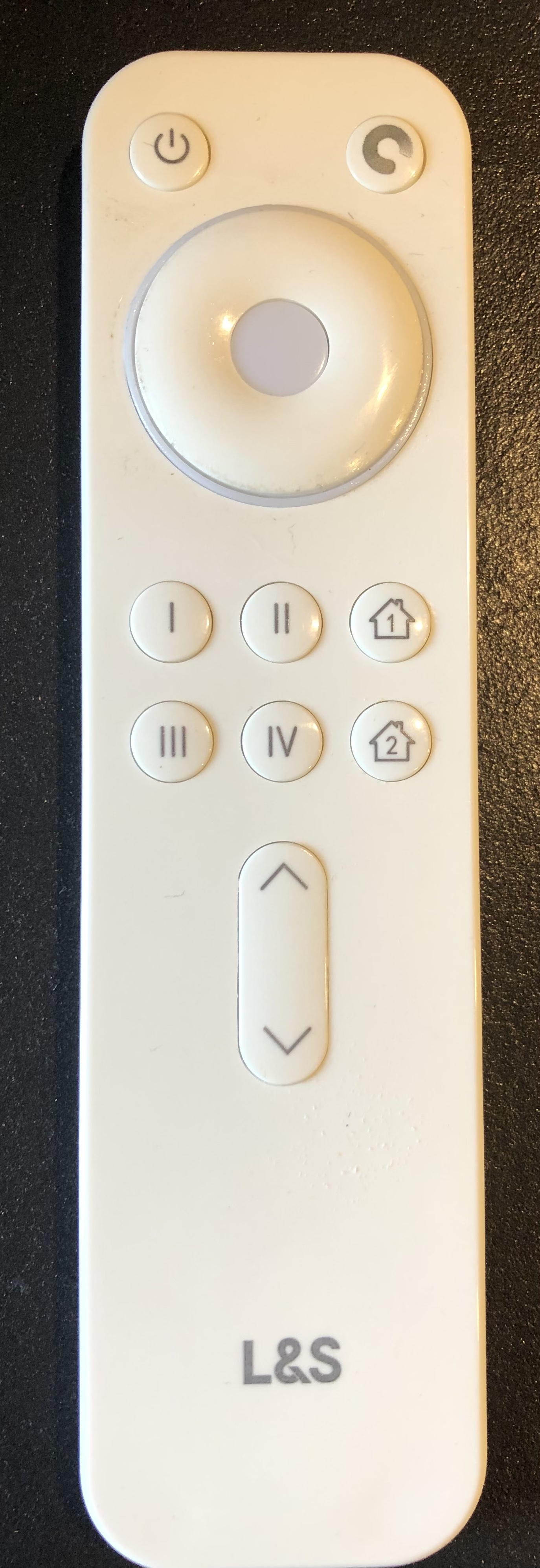

The 4-channel remote control

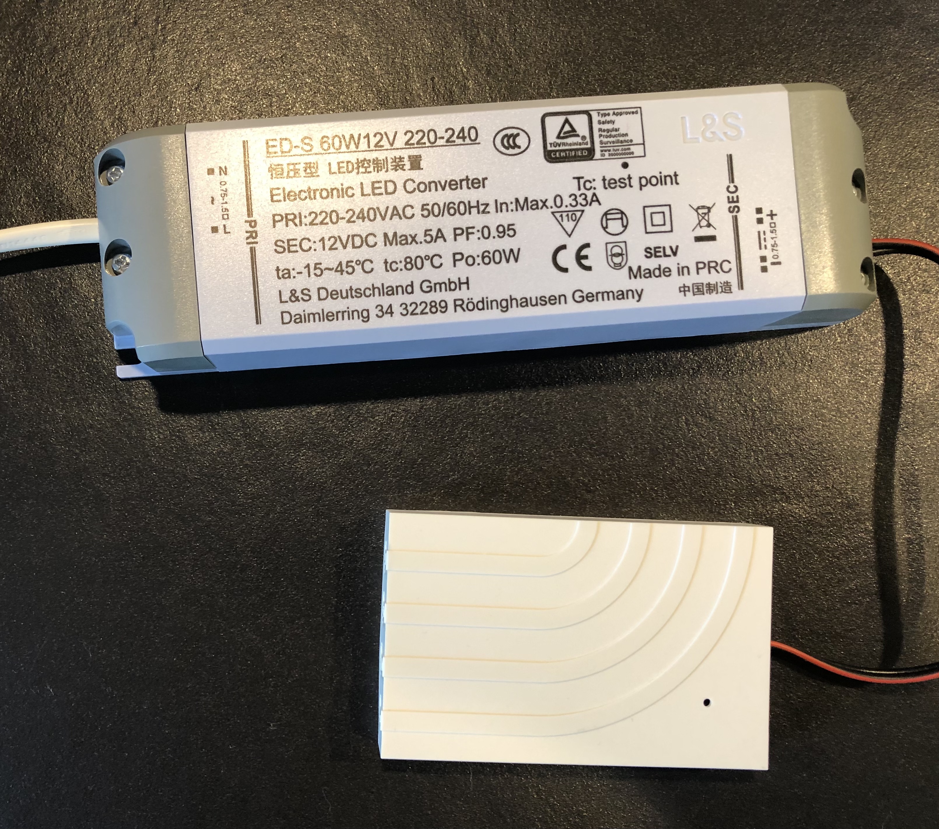

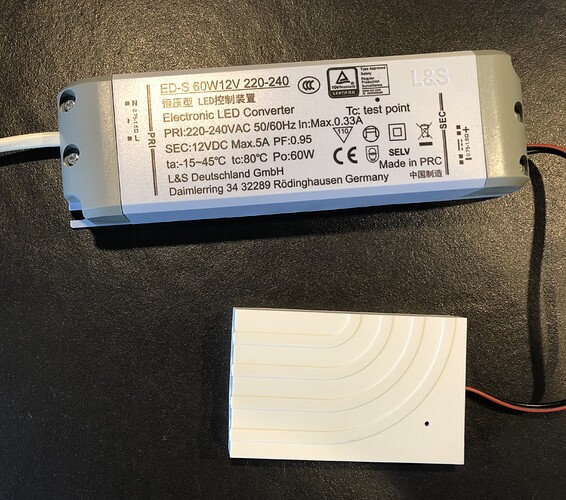

A driver which was also available, but i am not sure if i have to use it
