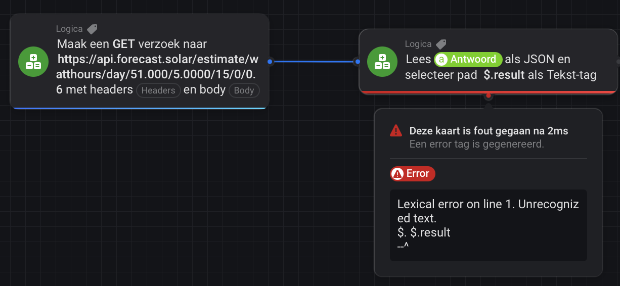

Thank you for your reply. When adding the THEN-card with (translated from Dutch):
"Read < answer > as JSON and select pad $.result.* as text-tag
Results in error:
Lexical error on line 1. Unrecognized text.
$. $.result.*
Any suggestions?

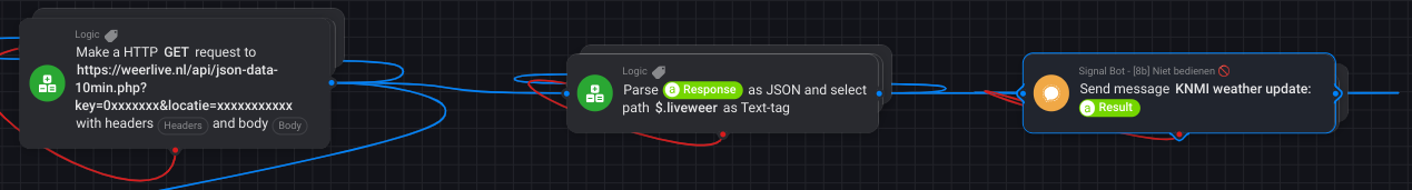

I use this (it returns the contents of ‘liveweer’)

Hmmmm, when I feed your JSON to the parse card, it works. I always compare the original http get result as well when things aren’t going as expected.
Oh, and I learned something new
The path $.result.* returns the values only, omitting the dates :wink: @OH2TH was totally right

Then I’m certain I’m doing something wrong. I’ve copied all your cards @Peter_Kawa, but I still get the same error.
Are you sure there’s no hidden leading / trailing whitespace, in the $.result… line?
Thank you… :see_no_evil:
