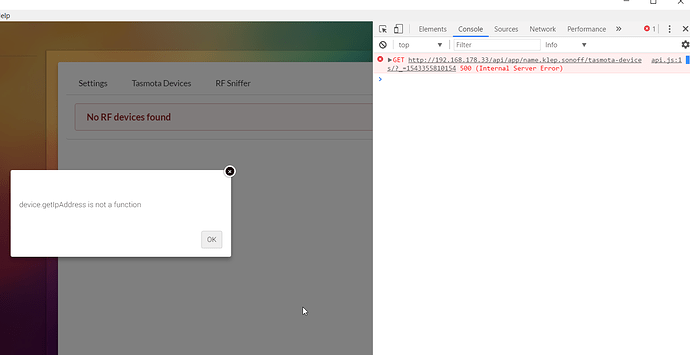

I’ve tried rebooting the Sonoff App while Homey and MQTT broker is running. That doesn’t solve it unfortunately. The MQTT is receiving status updates continuously from the sonoffs but somehow the connection to the sonoff app is broken…
Any idea? popup comes when trying the settings tab
Issue here: https://github.com/robertklep/name.klep.sonoff/issues/16
It seems to be related to devices that were added as “Generic (Tasmota)”. If at all possible, re-add the device with a more specific driver (like “S20” or “Basic”).
Time permitting, I will push a new release of the app soon that will hopefully fix this problem.
