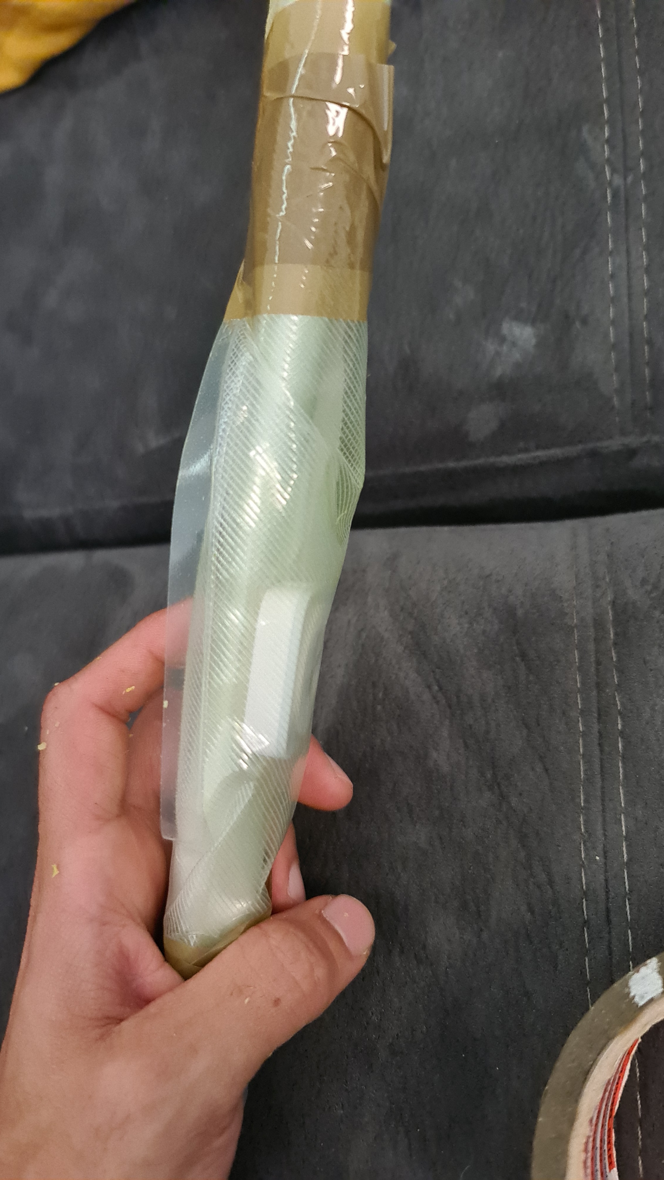

So far the most useful idead i had is to use aqara temp and pressure sensor, but to know the pressure bar i need to put the sensor in sealed vacuum bag with abit of air trapped…

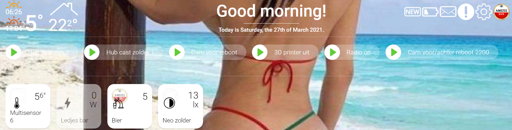

It is even possible to tell how many beers are left in the keg!
What u use ?
Something like this.
The loadcells are from the scale i bought at the local store for like 5 euro’s.
