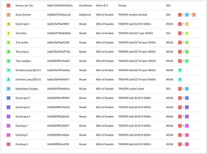

I have also different IKEA lamps in my house and garden. These are directly connected to homey
This is my mash network.
this is not really a nice network as I would expect
As stated in this topic before, this screenshot doesn’t mean there is no mesh created. Somehow this interface isn’t completely reliable. sometimes it shows the mesh directly or after a few seconds, sometimes it also takes minutes to load the map (at the moment it also took a long time for me (5 minutes). Some refreshing might help, not sure what is happening. Some refreshing might also NOT help, just refreshed and now my mesh is gone and all devices show a direct route again. And I’m sure that’s not the case as some temperature sensors are outside in the shed at the end of the backyard and therefore to far away for a direct route and they still report and update.
Edit: while typing this, the mesh appeared again in the developer tools interface.

the developer tools take a few minutes to load the current routes. As it is a mesh the routes are not static (to enable self healing and so on). What this probably means is that the developer page needs to get traffic to be able to identify what the current routes status is.
I also have these issues and the thing that struck me is that the only devices unable to do mesh routing are those that are labelled as “routers”. The devices that can do mesh routing are all battery powered and labelled as an “End Device”. The screenshots above, where there is any routing at all, all show the same problem.
This may not be a Homey fault. I haven’t checked yet, but, I have a feeling that this could be a device driver fault. I.e. the devices are not aware that they can use other routers to route their own traffic. If anyone here has experience of writing a device driver it would be great if you could confirm the theory?
Don’t be fooled by the developer page’s overview of the Zigbee “mesh”, because it is very likely not complete. Router devices can have several routes to other routers, including Homey, at the same time. However, the developer page will only show one of those routes (and which route that is, only Athom knows…).
Thanks for the response Robert. I accept that the mesh map may be incomplete and I won’t see all the routes, but it sounds like I should still see some of the mesh routes available for these devices. It just seems suspicious that the devices in my network that are “routers” only seem to have direct routes back to the hub. I believe these should also be able to do multi-hop routing so either the multi-hop routes are not showing at all (and it is a bug in the interface?) or they aren’t doing multi-hop routing.

Like I said, only one route is shown. You’d have to ask Athom how it chooses which route it shows for devices that can have multiple routes.
