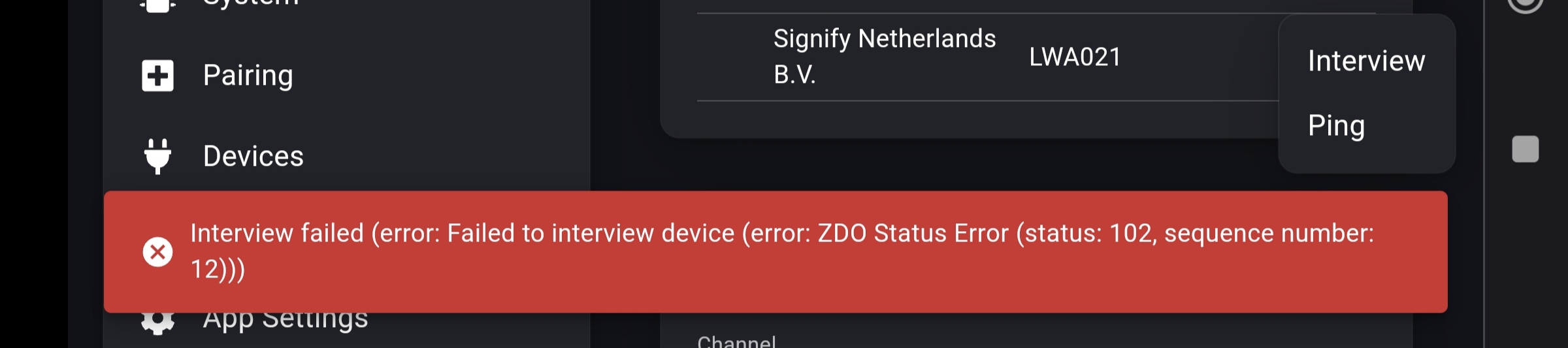

I try to interview a Philips Hue A60 (LWA021) light bulb at the developer page to add support for it (community app), so it won’t be seen as a generic zigbee device. I do not have a Philips Hue Bridge. That’s why I use this app.
However once I interview the light, it turns off/on a few times. So it seems it be interviewing. Then the light remains very bright. As a result the light is not working anymore and the only way to get it to work again is to reset the light bulb with a remote.
When I try to enable the device it mentions the device is not responding and asks if the device is connected to power:
When I try to interview it again, I receive a weird error message:
I use an homey pro (early 2023) with version 10.0.0-rc.122

Athom asked me to install rc133 and test it again.
I added the device again to get it to work again and with homey version 10.0.0-rc.133 I managed to interview the device. But I also waited much longer during the interview on developer page, this could also be the trick.
Although I did get an interview result. The device is unresponsive again in the homey app and Philips Hue BT app (outside homey). So lets wait for athom’s reply

I received this answer from Athom:
I checked with development about this.
Basic Zigbee devices are not added according to a driver file of a particular app. The interview function is mainly meant for developers who want to see what capabilities their device has received from the driver. So it may indeed be that devices that do not have a driver (basic Zigbee devices) cannot interview properly. This is not intended for interviewing driverless devices.
Everyone that want to add a basic zigbee device to a certain app, interview it first right? To give thia interview code to the developer, so they can add it to their app?
I don’t see a reason why the device would break after an interview… I never had it with my old Homey Pro (2019)
