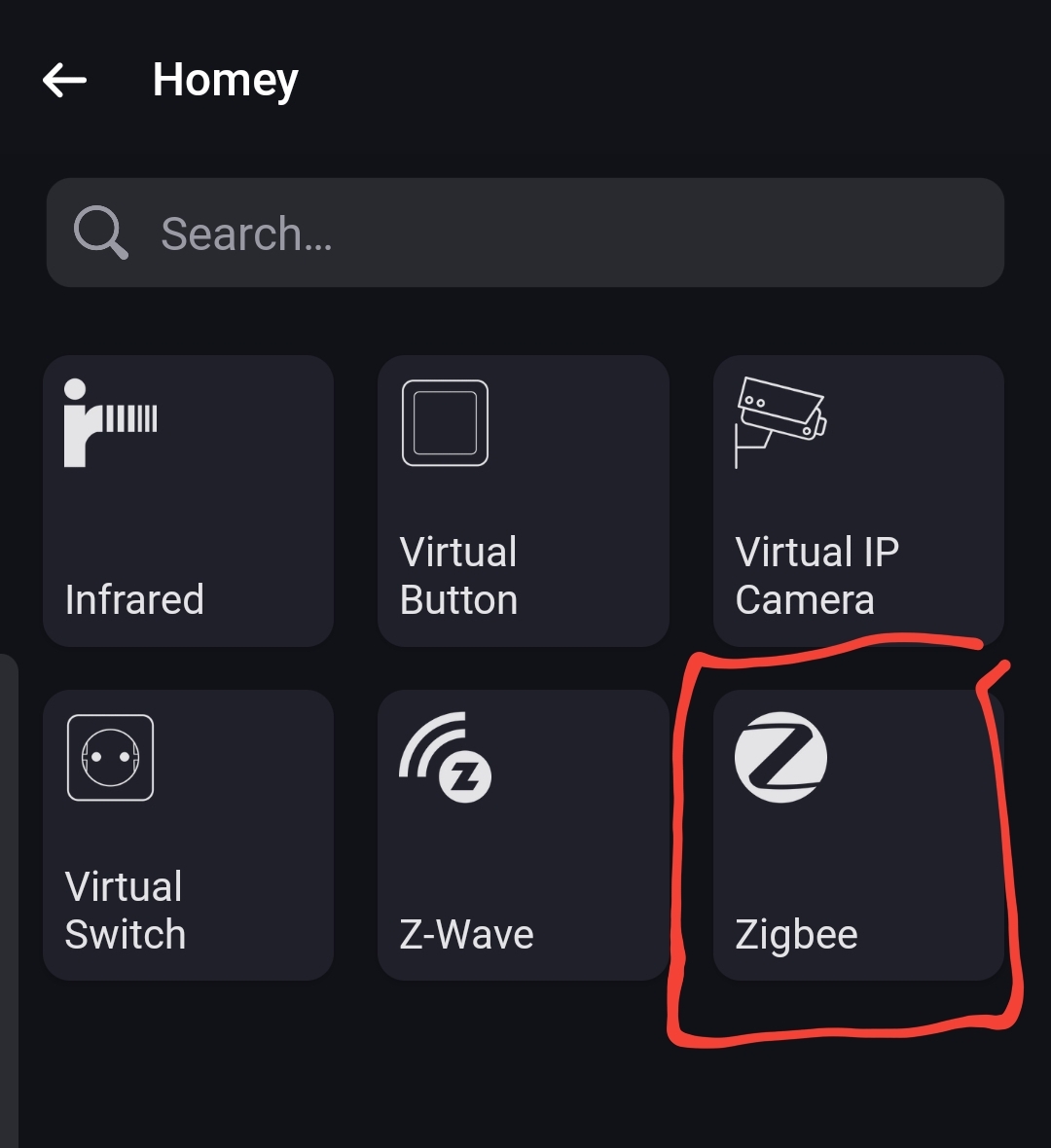

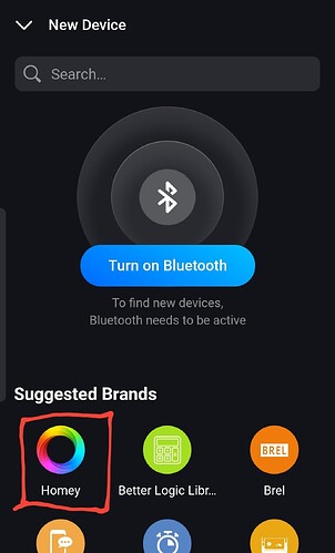

It should at least connect as Homey generic zigbee device.
Tell us which steps you tried, and where it stops.
Which Homey model do you own?
A. When you have sufficient zigbee routers (230V zigbee devices), start the pairing process near the lamp’s mounting point. A nearby zigbee router should pick up the signal;
B. When you have few zigbee routers, start the pairing process of the lamp a few centimeters from Homey.
From what I’ve read in the years, certain Innr devices are not very reliable slash stable zigbee products. Maybe this lamp is one of them.

You could also try pairing it as a generic Zigbee device to see if the lamp can be picked up at all.
Yeah try a few centimeters max., Sjoerd. Like mentioned before, try adding it as Homey generic zigbee device.
That should always work, if a light is supported or not.
