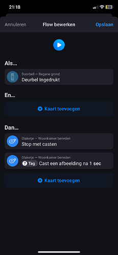

Make sure to add a “stop casting” card, and have the “cast a picture” card delayed for 1s.
Somehow it doesn’t start casting when it’s already casting something else.
That did the trick, thanks!
