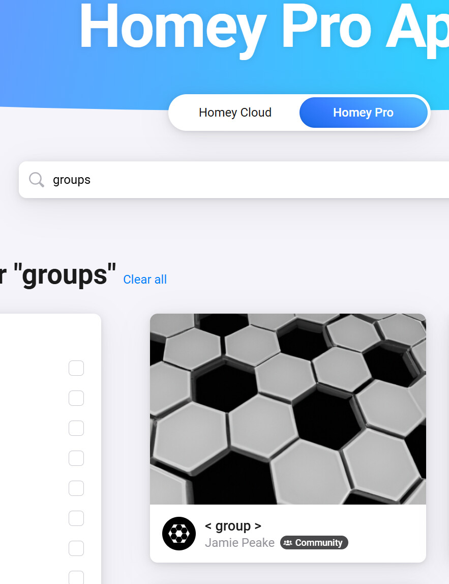

Which group type have you used ?

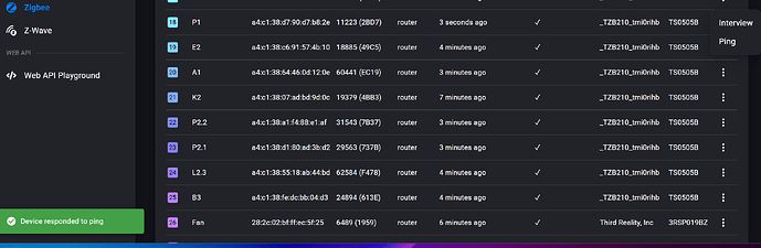

Do you mean Zigbee channel, not 2.4 GHz Wifi channel… based on your screenshot there is no interference.
Do not play with Zigbee channel, you would mostly end up with manual repair of all lights.
they are right now group in the homey tree and have tried the group ap no difference.

I had a very similar problem. I used the developer’s tools to verify everything was communicating properly. I shut everything down overnight. Powered it all back up and waited like a half hour. Everything works great.
  1. verify paths in developers’ tools. This will identify slow connections.
  2. If you find a slow connection see if a zigbee repeater will solve the problem.
  3. You can try powering down one controller at a time to see if it’s a bad controller.
  4. Power them all down and bring them up one at a time. See if you can find the culprit that way.
  5. Use groups. Group in 3’s and see if one of the groups causes the problem.
