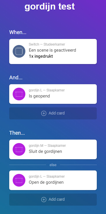

do you have found a solution for a good routine, that works with an aqara wireless mini switch and the fyrtur blinds? because I have the Problem, that I didn’t found a way that when the blind is closed and the button is pressed, blind go up. if the blind is up, and the button is pressed, then open the the blind.
I have just the option, that when position has changed, and “batterie alarm is on” than…

okay, thanks first :slight_smile: Because my Fyrtur Gordijn :slight_smile: is connected directly through homey, I miss that option, where I can activate the card “is open” is closed… That sucks.
I use an aqara switch to open / close the Fyrtur depending on the actual position. This works great.
https://homey.app/f/0gDYe-
Open pos = 0.99
Middle pos = 0.5
Closed pos = 0.01
Not using the logic variables gave me some problems. Also using 1 and 0 instead of 0.99 and 0.01. The blind sometimes roles the other way…
Last card is: set to (variable) closed pos. Don’t know why it’s not displayed correct when sharing the flow. For opening I use it the other way around
@Maurice you are my Hero. First thing: I didn’t know that I can active the aqara button as a scene, where I can select, how often I press him —> great!
Than the implementation with the variable from the logic with larger and or smaller than (in my case 0.7) A value… so I just need to press the mutton once, and it is doing exactly what I want. Thank you sir :wink:
