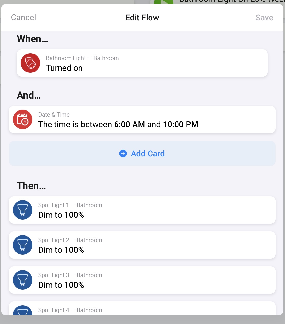

I have 5 IKEA gu10 spot lights - I set up a flow for when the light switch is turned on then it will turn on the lights - unfortunately it taking about 3 seconds from when the light switch is pressed to when the lights come on - not sure why this is happening

Also, Homey is not good at sending too many signals at once.
And, it fires all action cards at random (asynchronized)
It’s best to add a little delay between every 2 or 3 lights.
However, the flow editor’s smallest settable delay is one second, which is quite absurd.
When you group your lights, using an advanced virtual device (Device Capabilities app) or < group > app, devices are commanded synchronised (one after another, not at once), and with the < group > app you can add a delay in the milliseconds range if you like, it is added between every light command

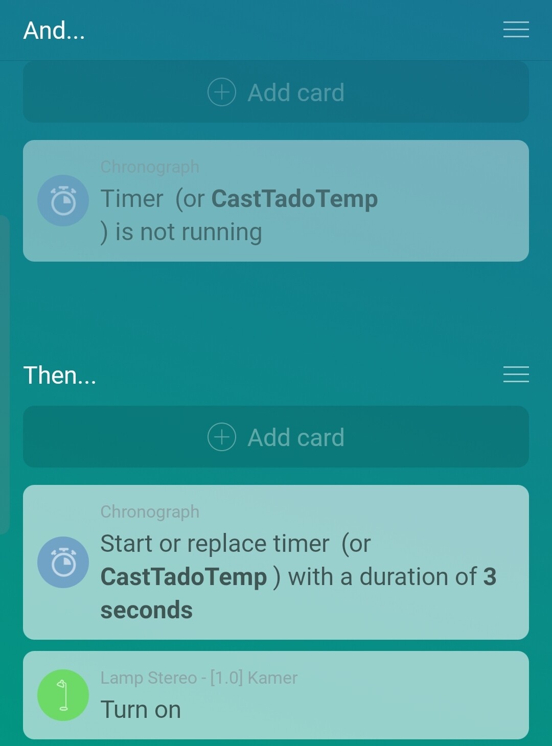

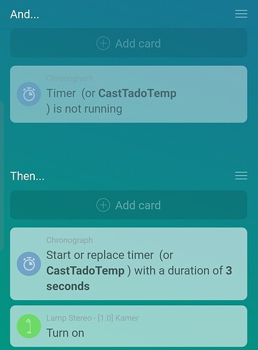

For too many on off actions in a row, you can add a timer which makes the trigger to be ignored for a few seconds, like this
