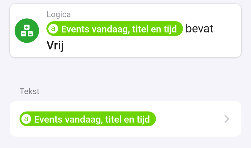

That is correct homey triggert it good. But in title is empty I forward it to wahtsapp but it says event start and empty lines. so again those all day events that start at 00:00 I have already added 5 seconds after them.
This is tonight.
started manually in adv flows then it does this and it is supposed to send it.
What’s presented in WhatsApp isn’t interesting to me. I need to know how it’s presented in Homey.
Please make a flow with the trigger Event starts and add a timeline notification or a push notification to your mobile (Homey) which have the Title tag as message.
Let me know what the outcome of that is.
Oh, and you are of course using the Title tag exposed from the trigger card and not one of the global tags available everywhere ??? :thinking:
No i use event title time and location. Is that the wrong ting?
