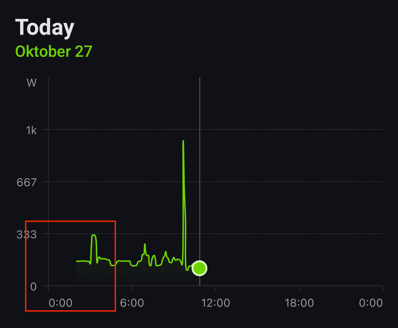

I use a HP23 (v10.1.0-rc.2), so maybe it’s not comparable. But I notice a glitch of 2 hours in Insights. The values of today starts at 02:00 o’clock and not at 00:00 o’clock:
I don’t know if this is just HP23 related, but this could explain why your flow(s) doesn’t work correctly.
I informed Athom support already.
Athom has inconvenienced a lot of developers by forcing every app to run in UTC when SDKv3 was introduced, but apparently they can’t even get their own stuff working properly ![]()
From coming Sunday, you’ll see that every day starts at 01:00… ![]()
Better than a gap of 2 hours… ![]()
