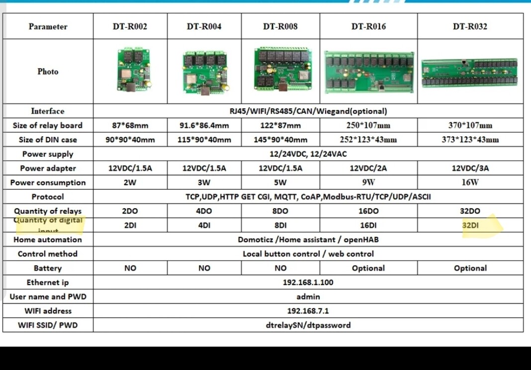

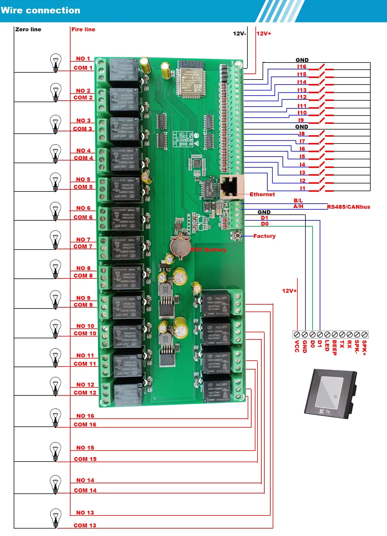

This 32-channel ESP32 board has 32 inputs and outputs, LAN and works via MQTT, and ‘thus’ with Homey:
https://a.aliexpress.com/_mOAK09Y

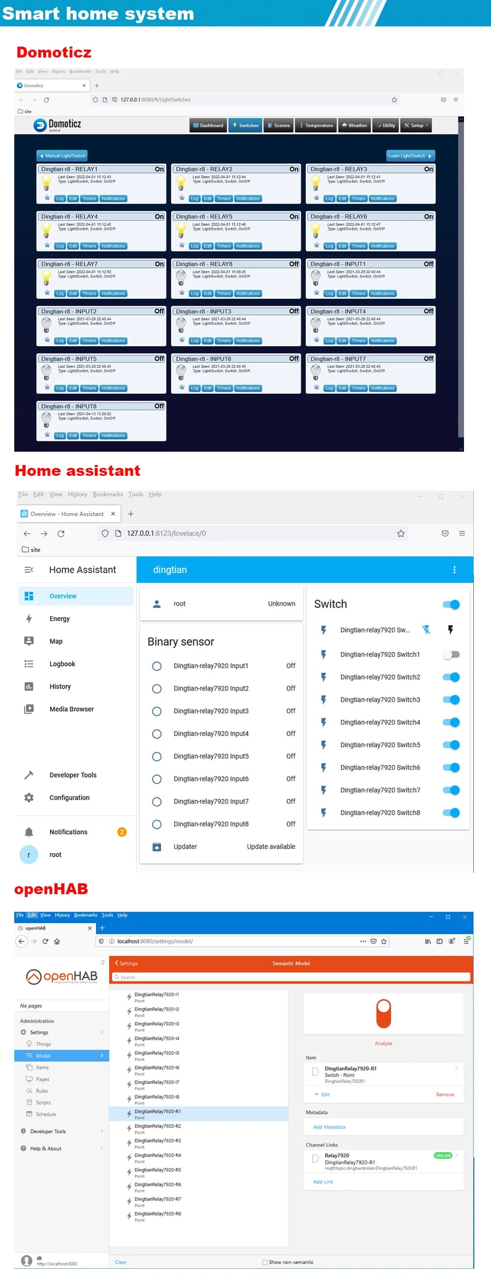

Home Assistant example:
Esp32 boards also work with the Homey ESPhome app.

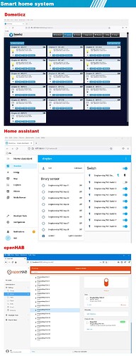

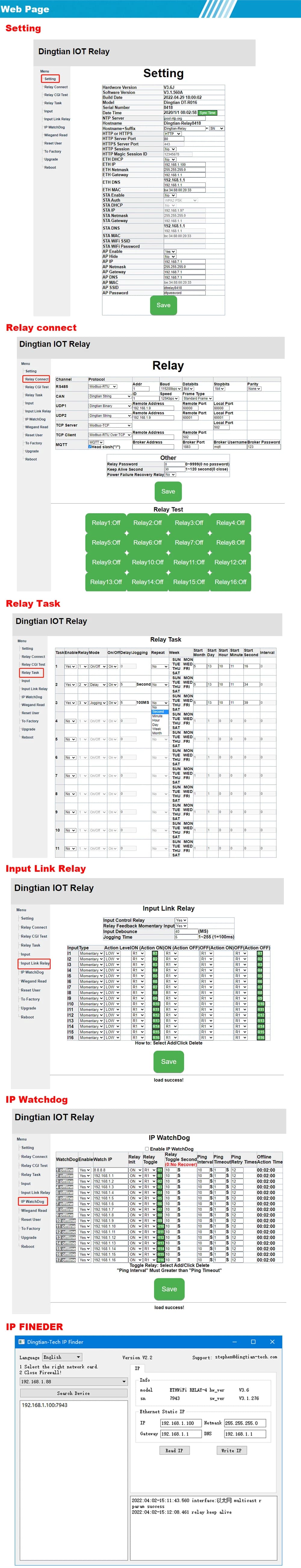

You never know with Uncle Ali, but to me it seems to be a ready-to-go unit, I just added some specs, web interface and Home Assistant pics.
