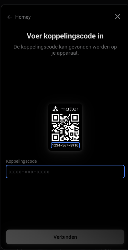

hmmm I have them all conected through the HUE Hub… I deleted my hue tap inside homey pro
and try to connect it with matter but no idea where to find the code which i need to enter in this screen… Did you do it the same way?
In the Hue app you find intergrations. Under smart home you can add a connection to other apps which will generate a code.
works! great! however all HUE lights are double now! :wink: delete
