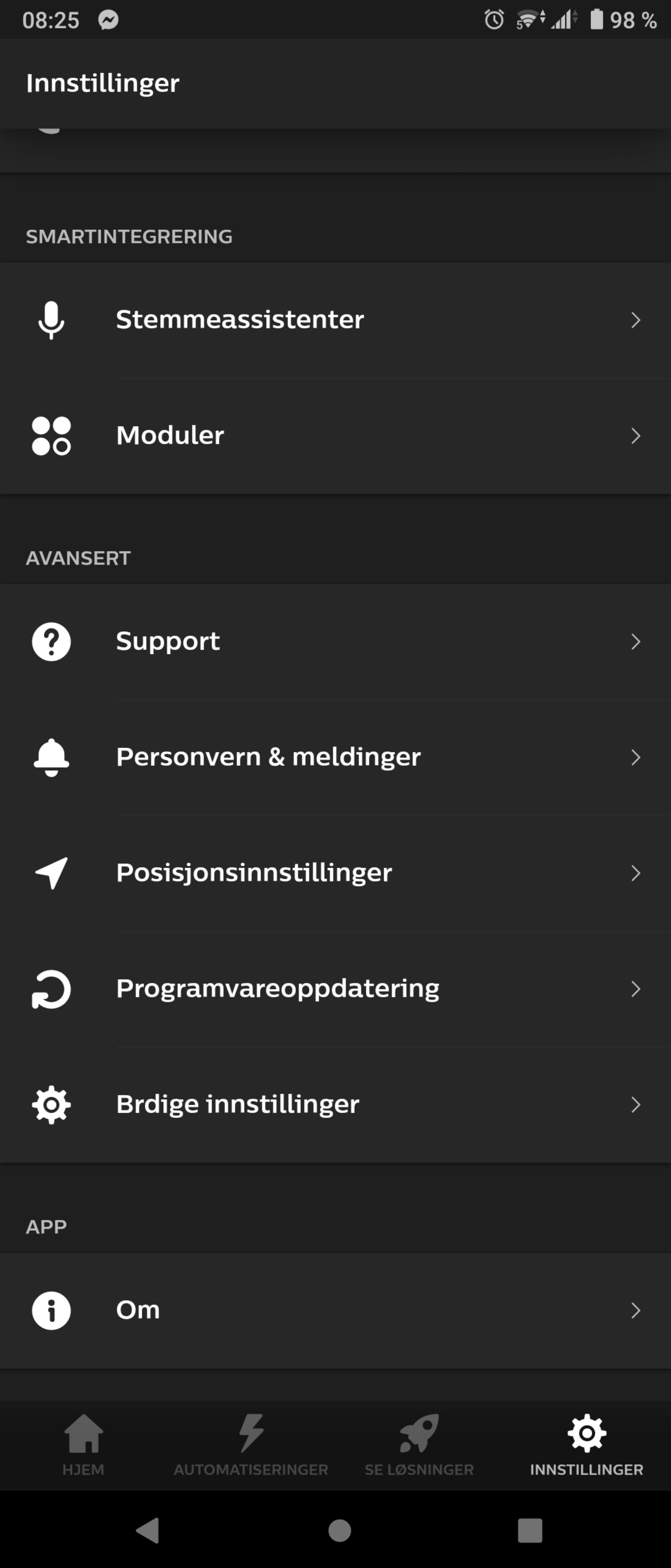

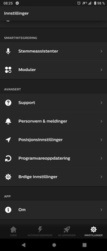

You can set fixed IP address for the Hue bridge in the android Hue app.
Text in screenshots are in Norwegian…
