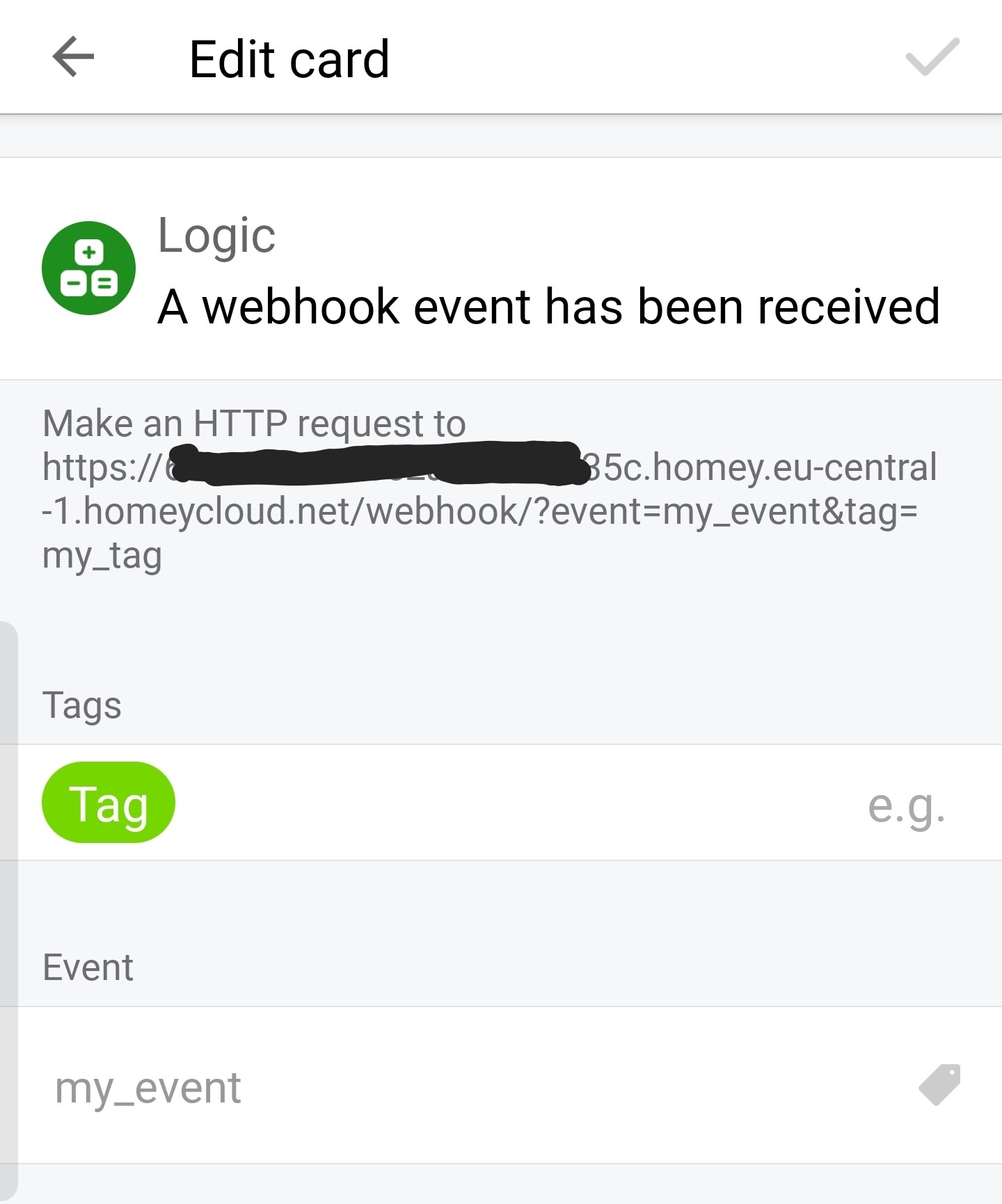

The URL is different from Homey Pro.
It’s also mentioned as example at the logics card “a webevent has been received” :wink:
Thanks Peter, good to know that there is indeed a different base url for the Pro version.
