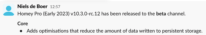

It was fixed :sweat_smile:
New stats:
 11:49:47 up 57 min,  1 user,  load average: 0.24, 0.20, 0.13
mmcblk0 425.528 M
…yep, still writes are higher than expected but in my case it has been also reduced significantly. Would be still great to see even more improvements
The question is how they did it.

No really - the issue was primarily the amount of RRD data (insights/graph), for Power users and saving them to storage immediately without any Caching. More apps more writes, almost growing exponentially … There are still some optimisations they can do, but that will not bring such a significant saving anymore.
