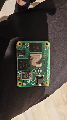

I got a CM4108032 modul for a decent price and I tried to replace it today. However, it seems that my thermal pads stuck on the raspbi board and not on the alu heatsink. I wasn’t able to move them to the new board without damaging. So I left everything as it was inserted the old board again.
To try it again, I need new thermal pads. Any hints what I should buy?

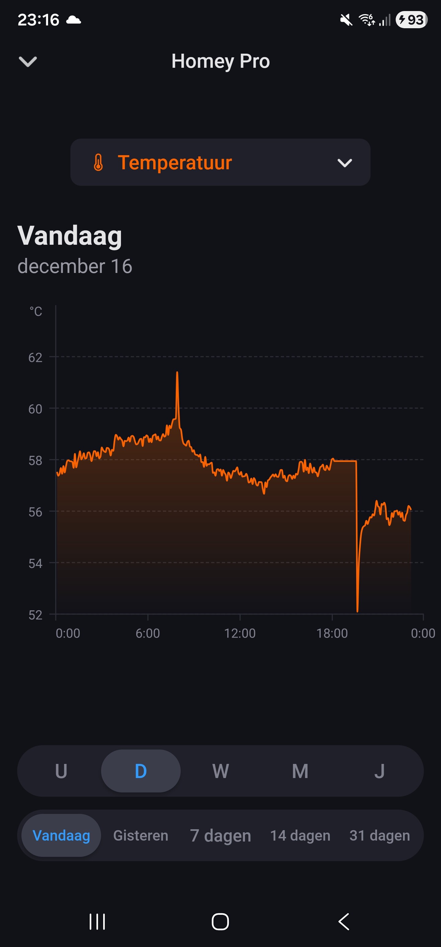

I also changed the cm4 today for a 8gb /32 gb and i take the thermal pad of with a nife :face_with_peeking_eye: put it on the new cm4 together with heat paste from my 3d printer.
Till now the temperature is lower then before
Always try using new thermal conductive pads when taking off the heat sink.
Got a bunch of them from Amazon and cut them to size.
