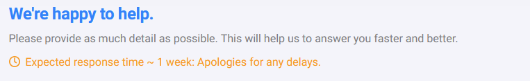

Go to https://homey.app/support
I’ve already submitted the ticket for assistance through your shared link 5 days ago. I was referring to their slow response on this.
I’ve already plough through all the available resources online (by Athom or Community) and tried all available “solutions” for past days… Seems likely the recent firmware update 5 days ago crashed my set.
And it seems like the support team is pretty slow as compared to other hubs I’ve tried.
