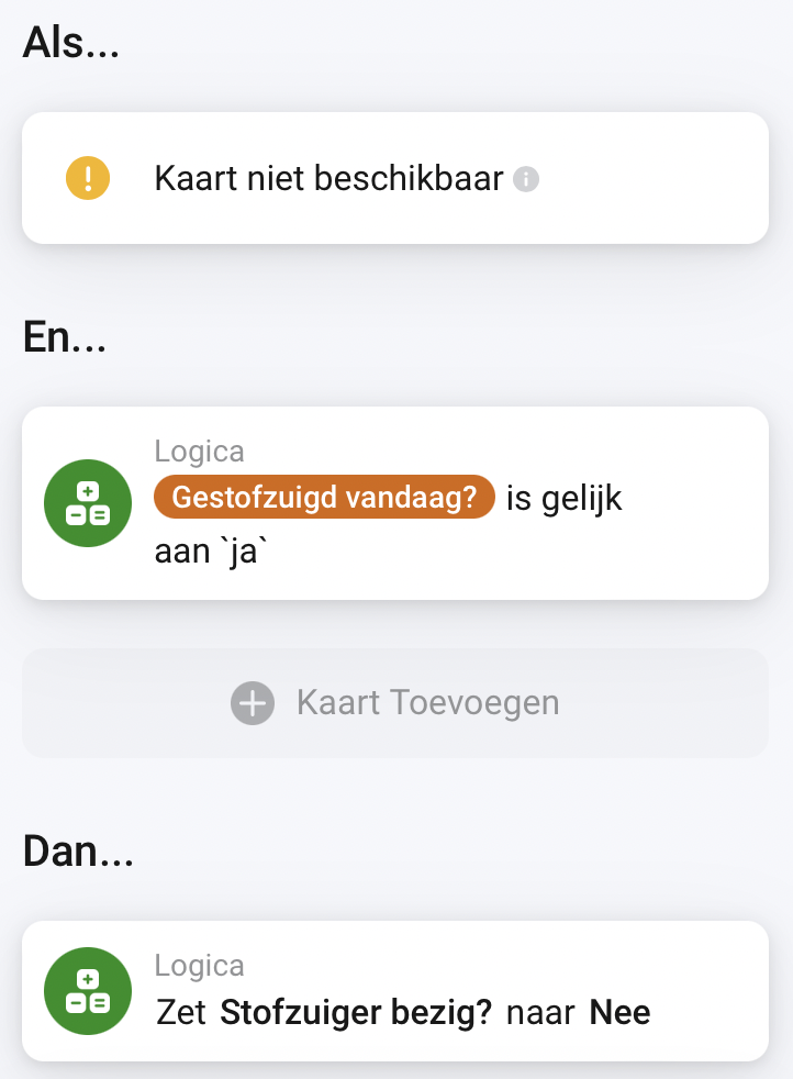

STEP 4
If the vacuum finishes his cycle, we need to register that.
How does this flow work?
  • The trigger is where the vacuum status changes to charging. Because: if the vacuum returns after finishing, that is the status it’ll have.
  • We check if the variable is set to true. This eliminates the charging status we also have in step 3.
  • As a result we change the other variable to no.
  • We leave the Gestofzuigd vandaag? variable untouched. Because the vacuum made a full cycle, so even when you leave the house again, it will not do another cycle.

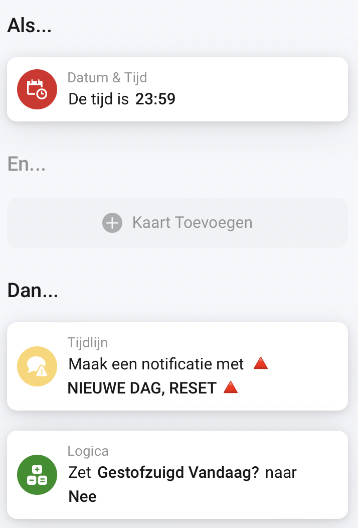

STEP 5
We need a daily reset! The Gestofzuigd vandaag? variable needs to be set to false at midnight.
  • At (one minute) for midnight this flow runs.
  • It sets the variable to false for another day of cleaning!
