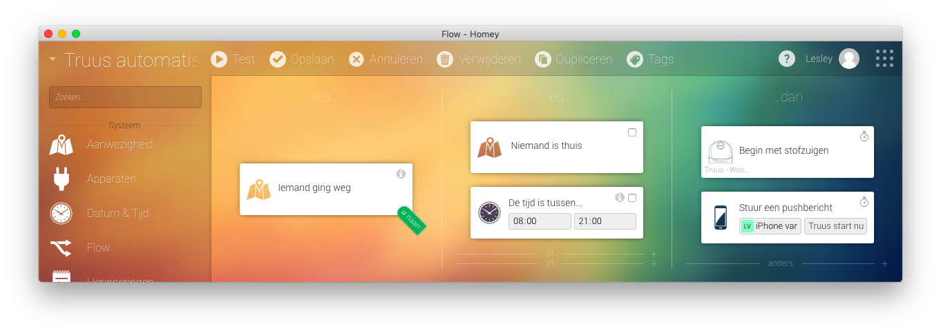

I have created a flow for my Neato Botvac D7 connected to start vacuuming when the last person leaves home. This flow works great! But if one of us comes home again, the flow will be triggered again. Sometimes this results in having Neato cleaning the floor 2 of 3 times in 1 day.

Add an extra card in your existing flow in the DAN schakel flow uit truus automatisch…
make an extra flow
ALS tijd is 21.00 uur DAN schakel flow in truus automatisch
Too easy!
Never thought about that one :slight_smile:
Thanks !!!
