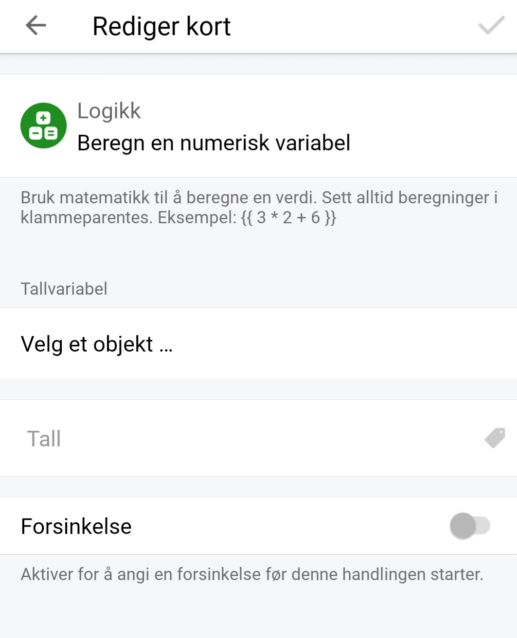

How to use logics with multiply and divide?
I tried to find a logic block for this, but not sure if there is one or this has to be set up like an expression?
I would like to show 200W in a tile instead of 0.2kW.
I can’t see how to add prefixes or move the comma when I set up an AVD with a textfield, is this possible?

Is the logic function with the ‘then’ card only option?
Seems like I have to create a variable aswell :thinking:
I had to try but found the solution…

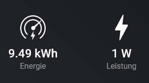

That’s an example power sensor:
grafik
That’s the AVD with an energy capability:
grafik
That’s the flow:
grafik
Don’t use the “set numeric field” flow card because there you can only use a tag or value, but no expression. Use the “set field to description”:
grafik
You can select your capability and as desctiption you set the math expression including your global tag from your source energy sensor.
