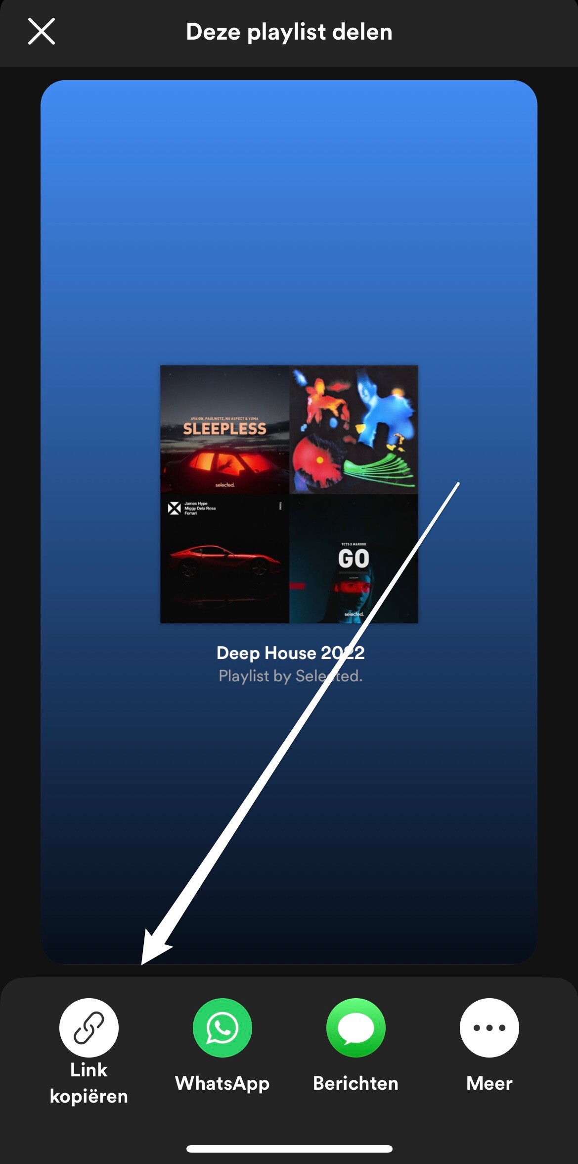

You can obtain the playlistid like this:
copy the next script and run. You can adjust your radiostations, playlist and radionames @ the remarks
