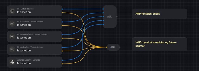

EDIT2: Well, I guess it just boils down to preference, then - and maybe I should rather go the scripting route? I, and it seems I’m pretty much alone in that position, miss something like AND/!AND or if/else - but that’s probably just the programmer in me.
Also, updating the logic for something like the image below will be a nightmare, cluttered as…well…yeah…you know and just a pain. In my not so humble opinion :wink:

EDIT: So, while it’s possible to do something like this, it’s just messy when one would expect to find another output from the all-card…Please note the “any” function won’t be synchronized with the “all” function, but rather fire as soon as any of these are false.
Why can’t you use the ANY and the ALL card in the same flow?
It’s just not futureproof, and I think it’s bad engineering not offering this the way other logic does. For this example it’s not very complicating, but when adding more layers it will start to get really inconvenient and hard to follow and debug the logic.
It is technically really hard to implement such a thing, and keep it user friendly, as the ALL card doesn’t have a timeout, it will just wait until the flow is fully finished for all inputs to be active.
So to add such a thing the ALL card would have to have a timeout value, but what would such a value be? some flows can take several minutes to finish with the wait card.

Ok, I managed to upload the image with another browser.
The problem here is that the “any” card will be true as soon as the first one of these are false. The “all” card will wait for all inputs. That’s a huge difference, even though the logic is the same.
My point is that if the inputs are 0, 1, 1 and 0, the else output should become true. If the inputs are , 1, 1 and 0, the neither of them should be true. In my alternate solution, the any and all functions won’t be synchronized, and the any function could fire even if the all function later changes.
The logic should be:
Output 1: if allInputsSet() { and(inputs{}); }
Output 2: if allInputsSet() { not(output1); }
…or something like that.

Correct,
As soon as the first one is false and continues the Any Route, the ALL card will stop processing as that one can’t become true in anytime. So, this is the way to go!
