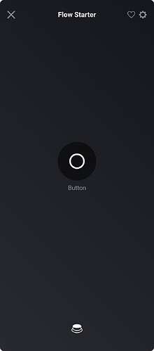

Works fine for me.
This is what it looks like in the web app:
