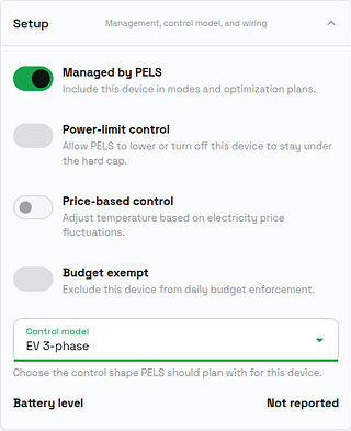

Step 1: Connect the charger to PELS
Give PELS control of the charging current first.
- Open Apps → PELS → Settings → Devices.
- Open your EV charger.
- Enable Managed by PELS.
- Choose EV 1-phase or EV 3-phase to match your charger.
- Create the current-control Flow described in Configure an EV Charger.
On a Zaptec? There’s a shorter path: Zaptec EV Charger.
The one setting to get right: turn power-limit control off
When you open the charger you’ll see a Power-limit control toggle. With a Smart task, turn it off and let the task do the driving. This one is worth understanding rather than just copying, because it’s where the two control modes from earlier collide.
A Smart task deliberately decides not to charge in certain hours, say the expensive early-evening block. But power-limit control doesn’t know about that plan. It only looks at whether there’s spare power under your cap. So if you leave it on, it will happily start the charger in exactly those hours the moment the house has room. You’d end up charging smeared across the hours the plan wanted empty (usually the pricier ones), which is the whole thing you were trying to avoid.
So the rule is simple: don’t drive the same device with both the caps feature and a Smart task. Pick one per device. For a Smart task that means:
- Managed by PELS: on
- Power-limit control: off
- The Smart task makes the charger available during its planned hours, and still keeps it under the hard cap while it runs.
