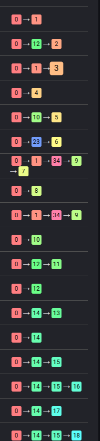

Thanks for this quite helpful write up. May I ask if these colors have any meaning beyond identifying a device?
No, it’s purely to identify the device a bit more easy
