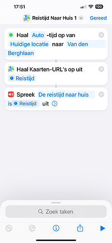

If you only need the traveltime: with ‘opdrachten’ you can have ‘kaarten’ calculate the traveltime and send this time as tag in a webhook to homey.

But this means you have to start the from opdrachten, but I would like to start it from a homey flow if possible.
