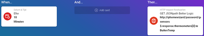

Then we make a flow to get the data from the Homewizard.
In the right colom card we put this on the left side:
http://IPHOMEWIZARD:PORT/PASSWORDHOMEWIZARD/get-sensors
In the middle we put:
$.response.thermometers[2].te
And to the right we put the name of the number variable u just made in the Better Logic app, in this case “BuitenTemp”
BuitenTemp
Now we get the outside temperature from the Homewizard every 10 minutes and u can use tags to make flows like:

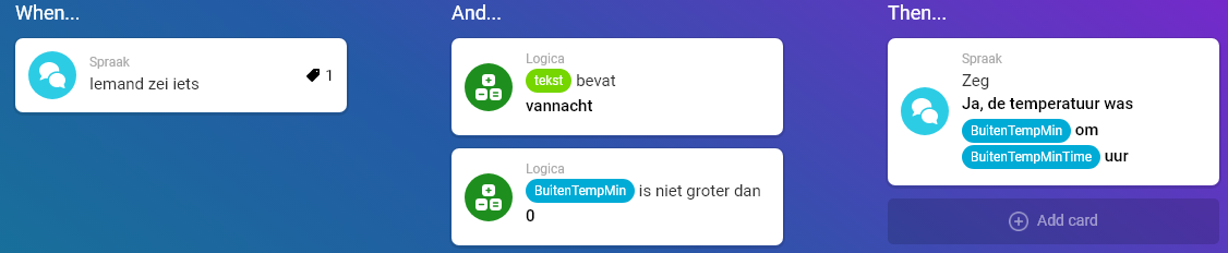

Now we can also make some flows (With the use of the tags) like asking if it was below 0 last night and get the answer with yes but also with the minimum temp AND the time it was that low:
